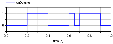

A rising edge of the Boolean input u gives a delayed output.A falling edge of the input is immediately given to the output.

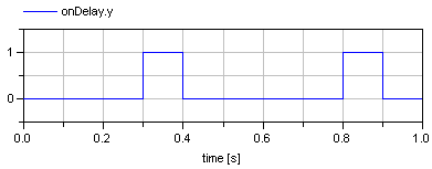

Simulation results of a typical example with a delay time of 0.1 sis shown in the next figure.

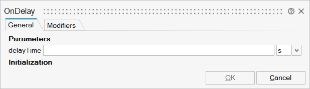

mo_delayTime | delayTime | Delay time | Scalar | |

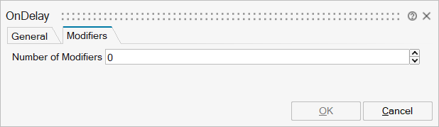

mo__modifiers/varname | Variable name | Cell of strings | 't_next' | |
mo__modifiers/value | Value |
