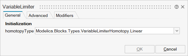

The parameter homotopyType in the Advanced tab specifies thesimplified behaviour if homotopy-based initialization is used:
NoHomotopy: the actual expression with limits is usedLinear: a linear behaviour y = u is assumed (default option)Fixed: it is assumed that the output is fixed at the valueySimplified
If it is known a priori in which region the input signal will be located, this option can helpa lot by removing one strong nonlinearity from the initialization problem.
mo_homotopyType | homotopyType | Simplified model for homotopy-based initialization | Structure | |
mo_homotopyType/choice1 | Modelica.Blocks.Types.VariableLimiterHomotopy.NoHomotopy | Number | 0 | |
mo_homotopyType/choice2 | Modelica.Blocks.Types.VariableLimiterHomotopy.Linear | Number | 0 | |
mo_homotopyType/choice3 | Modelica.Blocks.Types.VariableLimiterHomotopy.Fixed | Number | 0 |

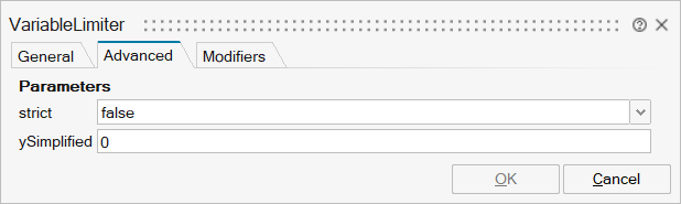

mo_strict | strict | = true, if strict limits with noEvent(..) | Scalar | true |
mo_ySimplified | ySimplified | Fixed value of output in simplified model | Scalar |

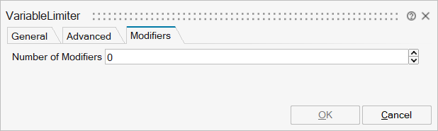

mo__modifiers/varname | Variable name | Cell of strings | 'simplifiedExpr' | |
mo__modifiers/value | Value |
