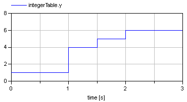

Example:
table = [ 0, 1; 1, 4; 1.5, 5; 2, 6];
results in the following output:

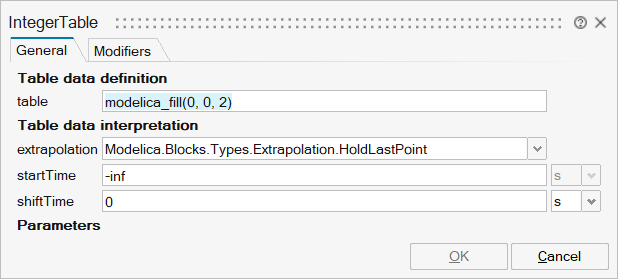

mo_table | table | Table matrix (first column: time; second column: y) | Matrix of size Mx2 | |
mo_extrapolation | extrapolation | Extrapolation of data outside the definition range | Structure | |
mo_extrapolation/choice1 | Modelica.Blocks.Types.Extrapolation.HoldLastPoint | Number | 0 | |
mo_extrapolation/choice2 | Modelica.Blocks.Types.Extrapolation.LastTwoPoints | Number | 0 | |
mo_extrapolation/choice3 | Modelica.Blocks.Types.Extrapolation.Periodic | Number | 0 | |
mo_extrapolation/choice4 | Modelica.Blocks.Types.Extrapolation.NoExtrapolation | Number | 0 | |
mo_startTime | startTime | Output = 0 for time < startTime | Scalar | |
mo_shiftTime | shiftTime | Shift time of first table column | Scalar | |
mo_n | n | Number of table points | Scalar |
