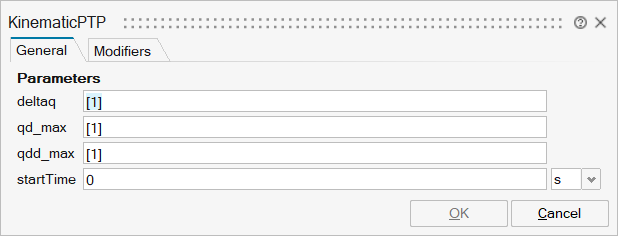

mo_deltaq | deltaq | Distance to move | Vector | |
mo_qd_max | qd_max | Maximum velocities der(q) | Vector | |
mo_qdd_max | qdd_max | Maximum accelerations der(qd) | Vector | |
mo_startTime | startTime | Time instant at which movement starts | Scalar | |

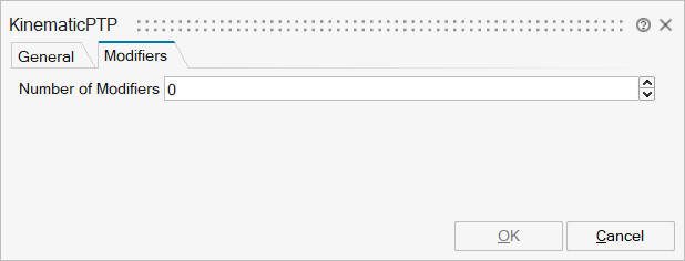

mo__modifiers/varname | Variable name | Cell of strings | 'sd_max' | |
mo__modifiers/value | Value |
