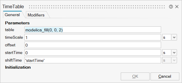

mo_table | table | Table matrix (time = first column; e.g., table=[0, 0; 1, 1; 2, 4]) | Matrix of size Mx2 | |
mo_timeScale | timeScale | Time scale of first table column | Scalar | |
mo_offset | offset | Offset of output signal y | Scalar | |
mo_startTime | startTime | Output y = offset for time < startTime | Scalar | |
mo_shiftTime | shiftTime | Shift time of first table column | Scalar | |

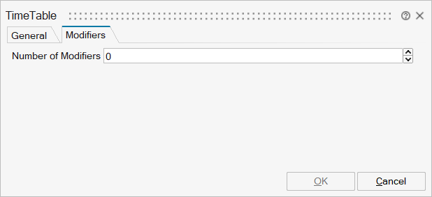

mo__modifiers/varname | Variable name | Cell of strings | 'a' | |
mo__modifiers/value | Value |
