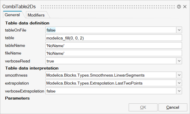

mo_tableOnFile | tableOnFile | = true, if table is defined on file or in function usertab | Scalar | true |
mo_table | table | Table matrix (grid u1 = first column, grid u2 = first row; e.g., table=[0, 0; 0, 1]) | Matrix | |
mo_tableName | tableName | Table name on file or in function usertab (see docu) | String | |
mo_fileName | fileName | File where matrix is stored | String | |
mo_verboseRead | verboseRead | = true, if info message that file is loading is to be printed | Scalar | true |
mo_smoothness | smoothness | Smoothness of table interpolation | Structure | |
mo_smoothness/choice1 | Modelica.Blocks.Types.Smoothness.LinearSegments | Number | 0 | |
mo_smoothness/choice2 | Modelica.Blocks.Types.Smoothness.ContinuousDerivative | Number | 0 | |
mo_smoothness/choice3 | Modelica.Blocks.Types.Smoothness.ConstantSegments | Number | 0 | |
mo_smoothness/choice4 | Modelica.Blocks.Types.Smoothness.MonotoneContinuousDerivative1 | Number | 0 | |
mo_smoothness/choice5 | Modelica.Blocks.Types.Smoothness.MonotoneContinuousDerivative2 | Number | 0 | |
mo_smoothness/choice6 | Modelica.Blocks.Types.Smoothness.ModifiedContinuousDerivative | Number | 0 | |
mo_extrapolation | extrapolation | Extrapolation of data outside the definition range | Structure | |
mo_extrapolation/choice1 | Modelica.Blocks.Types.Extrapolation.HoldLastPoint | Number | 0 | |
mo_extrapolation/choice2 | Modelica.Blocks.Types.Extrapolation.LastTwoPoints | Number | 0 | |
mo_extrapolation/choice3 | Modelica.Blocks.Types.Extrapolation.Periodic | Number | 0 | |
mo_extrapolation/choice4 | Modelica.Blocks.Types.Extrapolation.NoExtrapolation | Number | 0 | |
mo_verboseExtrapolation | verboseExtrapolation | = true, if warning messages are to be printed if table input is outside the definition range | Scalar | true |
mo_u_min | u_min | Minimum abscissa value defined in table | Vector of size 2 | |
mo_u_max | u_max | Maximum abscissa value defined in table | Vector of size 2 | |
mo_tableID | tableID | External table object | Scalar |

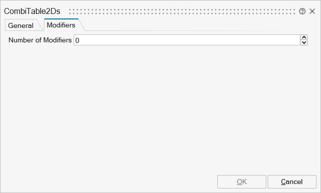

mo__modifiers/value | Value |
