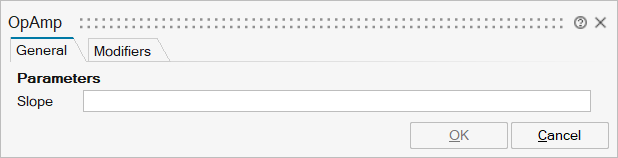

The OpAmp is a simple nonideal model with a smooth out.v = f(vin) characteristic, where "vin = in_p.v - in_n.v". The characteristic is limited by VMax.v and VMin.v. Its slope at vin=0 is the parameter Slope, which must be positive. (Therefore, the absolute value of Slope is taken into calculation.)
mo_Slope | Slope | Slope of the out.v/vin characteristic at vin=0 | Scalar |

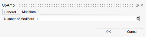

mo__modifiers/varname | Variable name | Cell of strings | 'vin' | |
mo__modifiers/value | Value |
