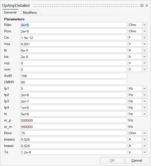

mo_Rdm | Rdm | Input resistance (differential input mode) | Scalar | |
mo_Rcm | Rcm | Input resistance (common mode) | Scalar | |
mo_Cin | Cin | Input capacitance | Scalar | |
mo_Vos | Vos | Input offset voltage | Scalar | |
mo_Ib | Ib | Input bias current | Scalar | |
mo_Ios | Ios | Input offset current | Scalar | |
mo_vcp | vcp | Correction value for limiting by p_supply | Scalar | |
mo_vcm | vcm | Correction value for limiting by msupply | Scalar | |
mo_Avd0 | Avd0 | Differential amplifier [dB] | Scalar | |
mo_CMRR | CMRR | Common-mode rejection [dB] | Scalar | |
mo_fp1 | fp1 | Dominant pole | Scalar | |
mo_fp2 | fp2 | Pole frequency | Scalar | |
mo_fp3 | fp3 | Pole frequency | Scalar | |
mo_fp4 | fp4 | Pole frequency | Scalar | |
mo_fz | fz | Zero frequency | Scalar | |
mo_sr_p | sr_p | Slew rate for increase | Scalar | |
mo_sr_m | sr_m | Slew rate for decrease | Scalar | |
mo_Rout | Rout | Output resistance | Scalar | |
mo_Imaxso | Imaxso | Maximal output current (source current) | Scalar | |
mo_Imaxsi | Imaxsi | Maximal output current (sink current) | Scalar | |
mo_Ts | Ts | Sampling time | Scalar | |
mo_vcp_abs | vcp_abs | Positive correction value for limiting by p_supply | Scalar | |
mo_vcm_abs | vcm_abs | Positive correction value for limiting by msupply | Scalar | |
mo_I1 | I1 | Current of internal source I1 | Scalar | |
mo_I2 | I2 | Current of internal source I2 | Scalar | |
mo_Avd0_val | Avd0_val | Differential mode gain | Scalar | |
mo_Avcm_val | Avcm_val | Common mode gain | Scalar | |
mo_sr_p_val | sr_p_val | Value of slew rate for increase | Scalar | |
mo_sr_m_val | sr_m_val | Negative value of slew rate for increase | Scalar | |
mo_Imaxso_val | Imaxso_val | Orientation out outp | Scalar | |
mo_Imaxsi_val | Imaxsi_val | Orientation into outp | Scalar |

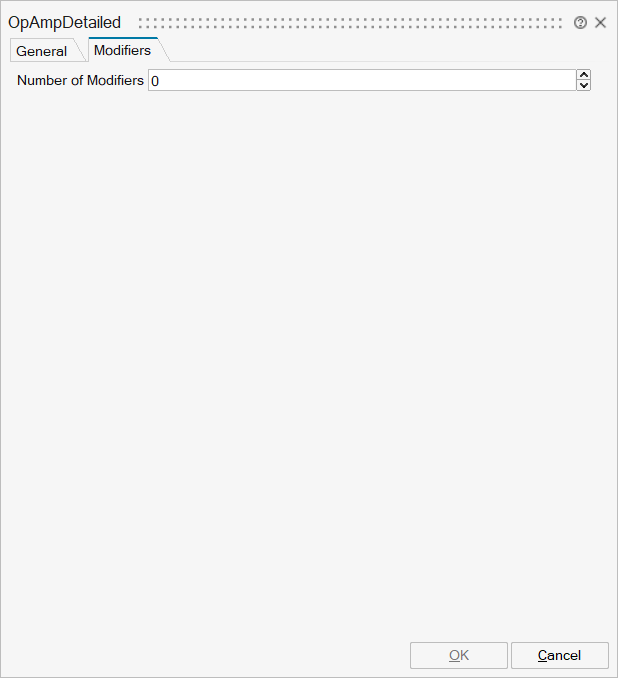

mo__modifiers/varname | Variable name | Cell of strings | 'v_pos' | |
mo__modifiers/value | Value |
