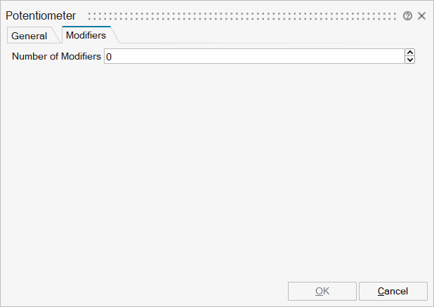

Potentiometer
Adjustable resistor
Modelica/Electrical/Analog/Basic
This models a potentiometer where the sliding contact is placed between pin_n (r = 0) and pin_p (r = 1), dependent on either the parameter rConstant or the signal input r.
The total resistance R is temperature dependent.
mo_R | R | Resistance at temperature T_ref | Scalar | |
mo_T_ref | T_ref | Reference temperature | Scalar | |
mo_alpha | alpha | Temperature coefficient of resistance (R_actual = R*(1 + alpha*(T_heatPort - T_ref)) | Scalar | |
mo_useHeatPort | useHeatPort | = true, if heatPort is enabled | Number | 0 |
mo_T | T | Fixed device temperature if useHeatPort = false | Scalar | |
mo_T_heatPort | T_heatPort | T_heatPort | Structure | |
mo_T_heatPort/fixed | fixed | Cell of scalars | true | |
mo_T_heatPort/start | start | Cell of scalars | ||
mo_useRinput | useRinput | Use input for 0<r<1 (else constant) | Number | 0 |
mo_rConstant | rConstant | Contact between n (r=0) and p (r=1) | Scalar |
mo__modifiers/varname | Variable name | Cell of strings | 'LossPower' | |
mo__modifiers/value | Value |
pin_p | implicit | input | 1 | |
contact | implicit | input | 2 | |
pin_n | implicit | output | 1 | |
Port 4 | implicit | Conditional heat port | input | mo_useHeatPort |
Port 5 | implicit | input | mo_useRinput |
