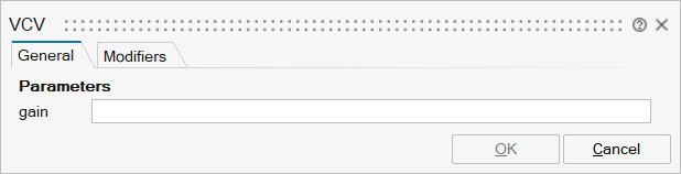

mo_gain | gain | Voltage gain | Scalar |
mo__modifiers/varname | Variable name | Cell of strings | 'v1' | |
mo__modifiers/value | Value |
