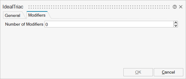

mo_Ron | Ron | Closed triac resistance | Scalar | |
mo_Goff | Goff | Opened triac conductance | Scalar | |
mo_Vknee | Vknee | Threshold voltage for positive and negative phase | Scalar | |
mo_Rdis | Rdis | Resistance of disturbance elimination | Scalar | |
mo_Cdis | Cdis | Capacity of disturbance elimination | Scalar |
mo__modifiers/value | Value |
fire1 | implicit | Gate | input | 1 |
n | implicit | Cathode | output | 1 |
p | implicit | Anode | input | 2 |
