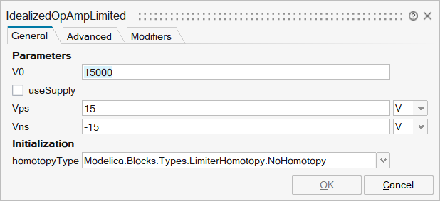

Idealized operational amplifier with saturation:
- Input currents are zero.
- No-load amplification is high (but not infinite).
- Output voltage is limited between positive and negative supply.
Supply voltage is either defined by parameter Vps and Vns or by (optional) pins s_p and s_n.
In the first case the necessary power is drawn from an implicit internal supply, in the second case from the external supply.
If initialization is problematic for a model containing this as a component you can set the homotopyType parameter.Using Linear ignores the saturation initially which simplifies the initialization, and may help if the componentis connected with negative feedback; but generally fails if the feedback is positive.Using LowerLimit (or UpperLimit) gives a fixed value within the saturation bounds, which works with positive feedback.However, it does not work if the intent is to initialize the input to give a specific output.
mo_V0 | V0 | No-load amplification | Scalar | |
mo_useSupply | useSupply | Use supply pins (otherwise constant supply) | Number | 0 |
mo_Vps | Vps | Positive supply voltage | Scalar | |
mo_Vns | Vns | Negative supply voltage | Scalar | |
mo_homotopyType | homotopyType | Simplified model for homotopy-based initialization | Structure | |
mo_homotopyType/choice1 | Modelica.Blocks.Types.LimiterHomotopy.NoHomotopy | Number | 0 | |
mo_homotopyType/choice2 | Modelica.Blocks.Types.LimiterHomotopy.Linear | Number | 0 | |
mo_homotopyType/choice3 | Modelica.Blocks.Types.LimiterHomotopy.UpperLimit | Number | 0 | |
mo_homotopyType/choice4 | Modelica.Blocks.Types.LimiterHomotopy.LowerLimit | Number | 0 |

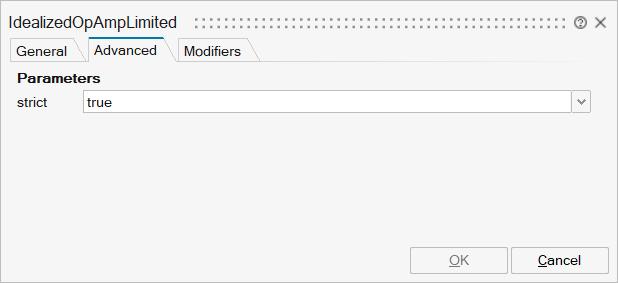

mo_strict | strict | = true, if strict limits with noEvent(..) | Scalar | true |

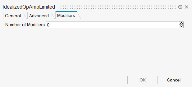

mo__modifiers/varname | Variable name | Cell of strings | 'vps' | |
mo__modifiers/value | Value |
