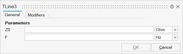

TLine3
Lossless transmission line with characteristic impedance Z0 and frequency F
Modelica/Electrical/Analog/Lines
Lossless transmission line with characteristic impedance Z0 and frequency F The lossless transmission line TLine3 is a two Port. Both port branches consist of a resistor with value of the characteristic impedance Z0 and a controlled voltage source that takes into consideration the transmission delay. For further details see [Branin1967]. Resistance R' and conductance C' per meter are assumed to be zero. The characteristic impedance Z0 can be derived from inductance and capacitance per length (L' resp. C'), i. e. Z0 = sqrt(L'/C'). The length of the line is equal to a quarter of the wavelength corresponding to the frequency F, i. e. the transmission delay is the quotient of 4 and F. In this case, the characteristic impedance is called natural impedance.
References: [Branin1967], [Hoefer1985]
mo_Z0 | Z0 | Natural impedance | Scalar | |
mo_F | F | Frequency | Scalar | |
mo_TD | TD | Scalar |
mo__modifiers/varname | Variable name | Cell of strings | 'v1' | |
mo__modifiers/value | Value |
