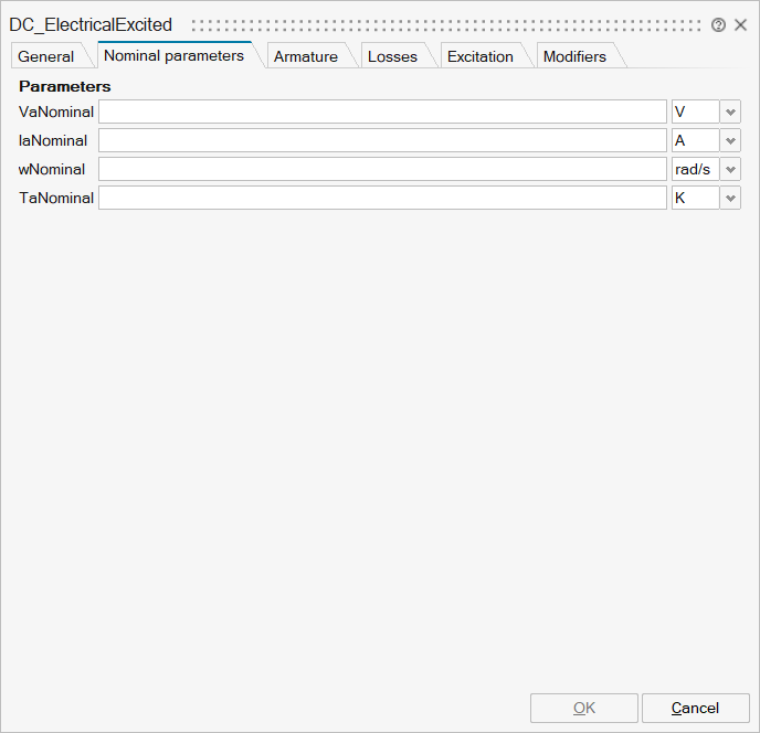

Default values for machine's parameters (a realistic example) are:
stator's moment of inertia | 0.29 | kg.m2 |
rotor's moment of inertia | 0.15 | kg.m2 |
nominal armature voltage | 100 | V |
nominal armature current | 100 | A |
nominal torque | 63.66 | Nm |
nominal speed | 1425 | rpm |
nominal mechanical output | 9.5 | kW |
efficiency | 95.0 | % only armature |
efficiency | 94.06 | % including excitation |
armature resistance | 0.05 | Ohm at reference temperature |
reference temperature TaRef | 20 | °C |
temperature coefficient alpha20a | 0 | 1/K |
armature inductance | 0.0015 | H |
nominal excitation voltage | 100 | V |
nominal excitation current | 1 | A |
excitation resistance | 100 | Ohm at reference temperature |
reference temperature TeRef | 20 | °C |
temperature coefficient alpha20e | 0 | 1/K |
excitation inductance | 1 | H |
stray part of excitation inductance | 0 | |
armature nominal temperature TaNominal | 20 | °C |
armature operational temperature TaOperational | 20 | °C |
(shunt) excitation operational temperature TeOperational | 20 | °C |

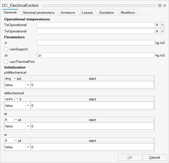

mo_TaOperational | TaOperational | Operational armature temperature | Scalar | |
mo_TeOperational | TeOperational | Operational (shunt) excitation temperature | Scalar | |
mo_Jr | Jr | Rotor's moment of inertia | Scalar | |
mo_useSupport | useSupport | Enable / disable (=fixed stator) support | Number | 0 |
mo_Js | Js | Stator's moment of inertia | Scalar | |
mo_useThermalPort | useThermalPort | Enable / disable (=fixed temperatures) thermal port | Number | 0 |
mo_ViNominal | ViNominal | Nominal induced Voltage | Scalar | |
mo_psi_eNominal | psi_eNominal | Nominal magnetic flux | Scalar | |
mo_turnsRatio | turnsRatio | Ratio of armature turns over number of turns of the excitation winding | Scalar | |
mo_Lme | Lme | Main part of excitation inductance | Scalar | |
mo_Lesigma | Lesigma | Stray part of excitation inductance | Scalar | |
mo_phiMechanical | phiMechanical | phiMechanical | Structure | |
mo_phiMechanical/fixed | fixed | Cell of scalars | true | |
mo_phiMechanical/start | start | Cell of scalars | ||
mo_wMechanical | wMechanical | wMechanical | Structure | |
mo_wMechanical/fixed | fixed | Cell of scalars | true | |
mo_wMechanical/start | start | Cell of scalars | ||
mo_ia | ia | ia | Structure | |
mo_ia/fixed | fixed | Cell of scalars | true | |
mo_ia/start | start | Cell of scalars | ||
mo_ie | ie | ie | Structure | |
mo_ie/fixed | fixed | Cell of scalars | true | |
mo_ie/start | start | Cell of scalars |

mo_VaNominal | VaNominal | Nominal armature voltage | Scalar | |
mo_IaNominal | IaNominal | Nominal armature current (>0..Motor, <0..Generator) | Scalar | |
mo_wNominal | wNominal | Nominal speed | Scalar | |
mo_TaNominal | TaNominal | Nominal armature temperature | Scalar |

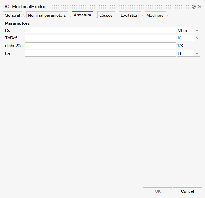

Name | Label | Description | Data Type | Valid Values |
mo_Ra | Ra | Armature resistance at TaRef | Scalar | |
mo_TaRef | TaRef | Reference temperature of armature resistance | Scalar | |
mo_alpha20a | alpha20a | Temperature coefficient of armature resistance | Scalar | |
mo_La | La | Armature inductance | Scalar |

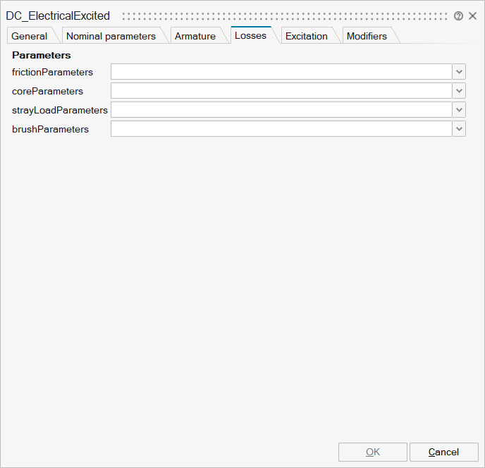

mo_frictionParameters | frictionParameters | Friction loss parameter record | FromModelica('Modelica.Electrical.Machines.Losses.FrictionParameters') | |
mo_coreParameters | coreParameters | Armature core loss parameter record | FromModelica('Modelica.Electrical.Machines.Losses.CoreParameters') | |
mo_strayLoadParameters | strayLoadParameters | Stray load loss parameter record | FromModelica('Modelica.Electrical.Machines.Losses.StrayLoadParameters') | |
mo_brushParameters | brushParameters | Brush loss parameter record | FromModelica('Modelica.Electrical.Machines.Losses.BrushParameters') |

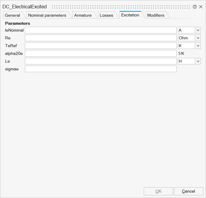

mo_IeNominal | IeNominal | Nominal excitation current | Scalar | |
mo_Re | Re | Field excitation resistance at TeRef | Scalar | |
mo_TeRef | TeRef | Reference temperature of excitation resistance | Scalar | |
mo_alpha20e | alpha20e | Temperature coefficient of excitation resistance | Scalar | |
mo_Le | Le | Total field excitation inductance | Scalar | |
mo_sigmae | sigmae | Stray fraction of total excitation inductance | Scalar |

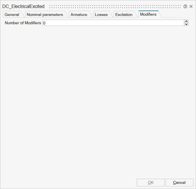

mo__modifiers/varname | Variable name | Cell of strings | 'tauElectrical' | |
mo__modifiers/value | Value |
