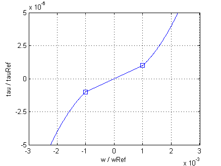

in the range -wLinear ≤ w ≤ wLinear with wLinear = 0.001 * wRef. The relationship of torqueand angular velocity is depicted in Fig. 1
Fig. 1: Friction loss torque versus angular velocity for power_w = 2 |

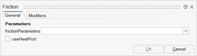

If it is desired to neglect friction losses, set frictionParameters.PRef = 0 (this is the default).
mo_frictionParameters | frictionParameters | Friction loss parameters | FromModelica('Modelica.Electrical.Machines.Losses.FrictionParameters') | |
mo_useHeatPort | useHeatPort | = true, if heatPort is enabled | Number | 0 |

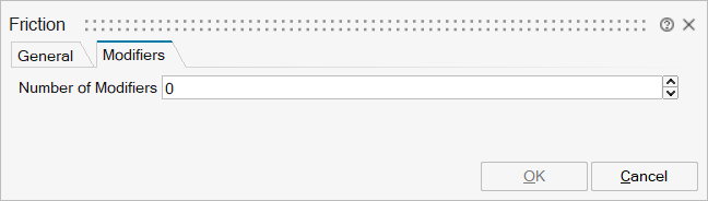

mo__modifiers/varname | Variable name | Cell of strings | 'phi' | |
mo__modifiers/value | Value |
