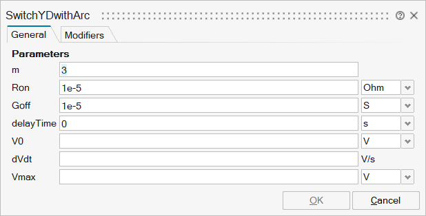

SwitchYDwithArc
Y-D-switch with arc
Modelica/Electrical/Machines/Utilities
Star-Delta-switch with arc when switch opens.If control is false, plug_sp and plug_sn are star connected and plug_sp connected to the supply plug.
If control is true, plug_sp and plug_sn are delta connected and they are connected to the supply plug.
Note there is a delay between opening star connection and closing delta connection, respectively opening delta connection and closing star connection.
mo_Ron | Ron | Closed switch resistance | Scalar | |
mo_Goff | Goff | Opened switch conductance | Scalar | |
mo_delayTime | delayTime | Time delay | Scalar | |
mo_V0 | V0 | Initial arc voltage | Scalar | |
mo_dVdt | dVdt | Arc voltage slope | Scalar | |
mo_Vmax | Vmax | Max. arc voltage | Scalar |
mo__modifiers/value | Value |
