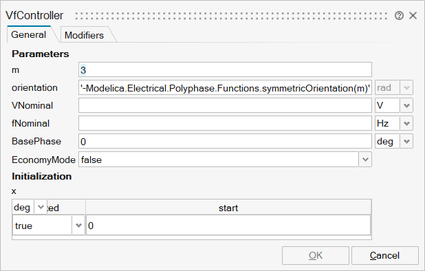

Simple Voltage-Frequency-Controller.Amplitude of voltage is linear dependent (VNominal/fNominal) on frequency (input signal "u"), but limited by VNominal (nominal RMS voltage per phase).
m sine-waves with amplitudes as described above are provided as output signal "y".
By setting parameter EconomyMode=true, Voltage rises quadratically with frequency which means flux,torque and loss reduction for fan and pump drives.
The sine-waves are intended to feed a m-phase SignalVoltage.
Phase shifts between sine-waves may be chosen by the user; default values are (k-1)/m*pi for k in 1:m.
mo_nout | nout | Number of outputs | Scalar | |
mo_orientation | orientation | Orientation of phases | Vector | |
mo_VNominal | VNominal | Nominal RMS voltage per phase | Scalar | |
mo_fNominal | fNominal | Nominal frequency | Scalar | |
mo_BasePhase | BasePhase | Common phase shift | Scalar | |
mo_EconomyMode | EconomyMode | Economy mode: voltage quadratic dependent on frequency | Scalar | true |
mo_pow | pow | Scalar | ||
mo_x | x | x | Structure | |
mo_x/fixed | fixed | Cell of scalars | true | |
mo_x/start | start | Cell of scalars |

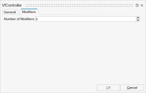

mo__modifiers/varname | Variable name | Cell of strings | 'amplitude' | |
mo__modifiers/value | Value |
u | implicit | Connector of Real input signal | input | 1 |
y | implicit | Connector of Real output signals | output | 1 |
