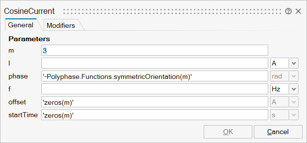

Contains m cosine current sources (Modelica.Electrical.Analog.Sources.CosineCurrent)with a default phase shift determined bysymmetricOrientation.
mo_I | I | Amplitudes of cosine waves | Vector | |
mo_phase | phase | Phases of cosine waves | Vector | |
mo_f | f | Frequencies of cosine waves | Vector | |
mo_offset | offset | Current offsets | Vector | |
mo_startTime | startTime | Time offsets | Vector |

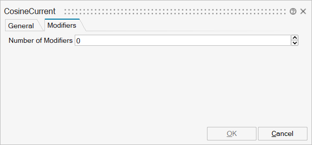

mo__modifiers/varname | Variable name | Cell of strings | 'v' | |
mo__modifiers/value | Value |
