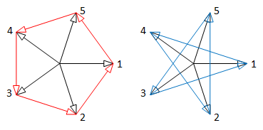

Polygon connection
For polyphase systems, star connection of the m phases is unambiguous, i.e., each pin of the plug is connected to the starpoint pin,whereas for polygon connection (mBase - 1)/2 alternatives exist (refer to Fig. 3).
2 phase system | 2 = 2 x 2 phase system |
3 phase system | 6 = 2 x 3 phase system |
5 phase system: 2 alternative polygon connections | 7 phase system: 3 alternative polygon connections |
Therefore, using the MultiDelta component,the alternative has to be specified by the parameter kPolygon.
