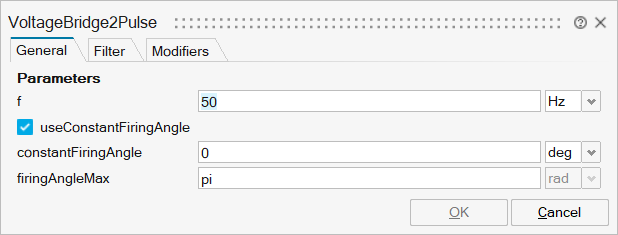

Name | Label | Description | Data Type | Valid Values |
mo_f | f | Frequency | Scalar | |
mo_useConstantFiringAngle | useConstantFiringAngle | Use constant firing angle instead of signal input | Number | 0 |
mo_constantFiringAngle | constantFiringAngle | Firing angle | Scalar | |
mo_firingAngleMax | firingAngleMax | Maximum firing angle | Scalar |

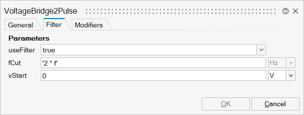

mo_useFilter | useFilter | Enable use of filter | Scalar | true |
mo_fCut | fCut | Cut off frequency of filter | Scalar | |
mo_vStart | vStart | Start voltage of filter output | Scalar |

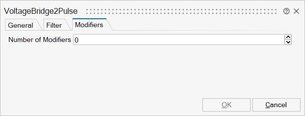

mo__modifiers/value | Value |
