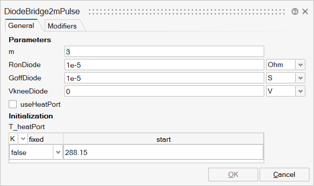

This is a 2*m pulse diode rectifier bridge. In order to operate this rectifier a voltage source with center tap is required. The circuit topology is the same as inExamples.ACDC.RectifierBridge2mPulse. It is important to note that for polyphase circuits with even phase numbers greater than three theMultiStarResistance shall be used for grounding the voltage sources.
Name | Label | Description | Data Type | Valid Values |
mo_RonDiode | RonDiode | Closed diode resistance | Scalar | |
mo_GoffDiode | GoffDiode | Opened diode conductance | Scalar | |
mo_VkneeDiode | VkneeDiode | Diode forward threshold voltage | Scalar | |
mo_useHeatPort | useHeatPort | = true, if heatPort is enabled | Number | 0 |
mo_T | T | Fixed device temperature if useHeatPort = false | Scalar | |
mo_T_heatPort | T_heatPort | T_heatPort | Structure | |
mo_T_heatPort/fixed | fixed | Cell of scalars | true | |
mo_T_heatPort/start | start | Cell of scalars |

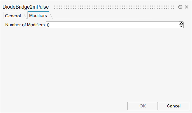

mo__modifiers/varname | Variable name | Cell of strings | 'vAC' | |
mo__modifiers/value | Value |
