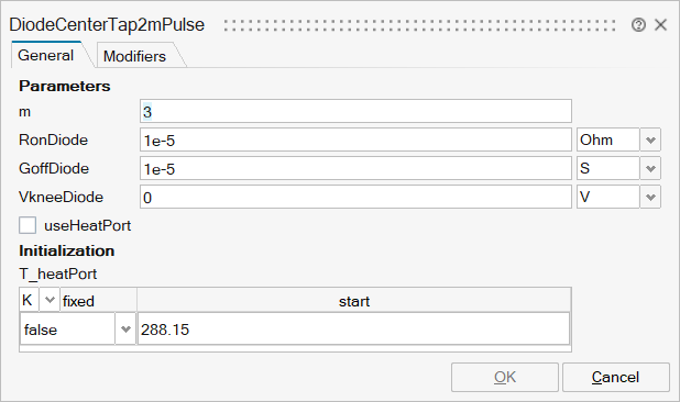

This is a 2*m pulse diode rectifier with center tap. In order to operate this rectifier a voltage source with center tap is required. The center tap has to be connected with the negative pin of the load. The circuit topology is the same as inExamples.ACDC.RectifierCenterTap2mPulse.
mo_RonDiode | RonDiode | Closed diode resistance | Scalar | |
mo_GoffDiode | GoffDiode | Opened diode conductance | Scalar | |
mo_VkneeDiode | VkneeDiode | Diode forward threshold voltage | Scalar | |
mo_useHeatPort | useHeatPort | = true, if heatPort is enabled | Number | 0 |
mo_T | T | Fixed device temperature if useHeatPort = false | Scalar | |
mo_T_heatPort | T_heatPort | T_heatPort | Structure | |
mo_T_heatPort/fixed | fixed | Cell of scalars | true | |
mo_T_heatPort/start | start | Cell of scalars |

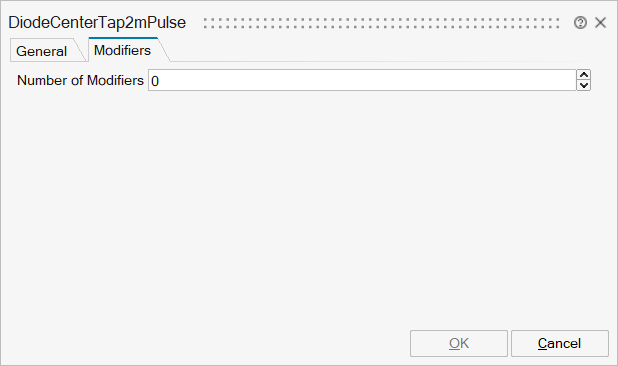

mo__modifiers/varname | Variable name | Cell of strings | 'vAC' | |
mo__modifiers/value | Value |
