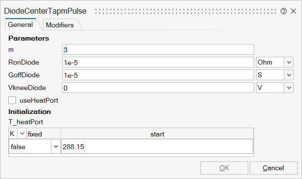

This is a m pulse diode rectifier with center tap. All voltage sources must have one interconnected plug (tap). This rectifiers works only with odd number of phases due the symmetry constrains of even phase numbers implemented insymmetricOrientation.The circuit topology is the same as inExamples.ACDC.RectifierCenterTapmPulse.
mo_RonDiode | RonDiode | Closed diode resistance | Scalar | |
mo_GoffDiode | GoffDiode | Opened diode conductance | Scalar | |
mo_VkneeDiode | VkneeDiode | Diode forward threshold voltage | Scalar | |
mo_useHeatPort | useHeatPort | = true, if heatPort is enabled | Number | 0 |
mo_T | T | Fixed device temperature if useHeatPort = false | Scalar | |
mo_T_heatPort | T_heatPort | T_heatPort | Structure | |
mo_T_heatPort/fixed | fixed | Cell of scalars | true | |
mo_T_heatPort/start | start | Cell of scalars |

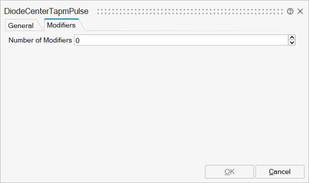

mo__modifiers/varname | Variable name | Cell of strings | 'vAC' | |
mo__modifiers/value | Value |
