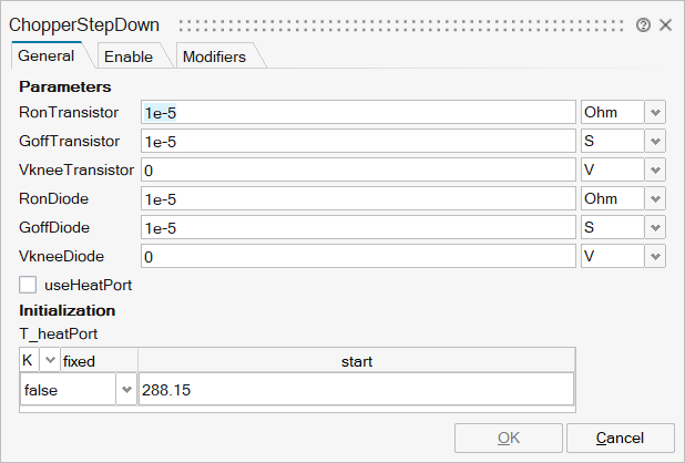

This is a conventional step down chopper (buck converter) model. It consists of a transistor and free wheeling diode.
mo_RonTransistor | RonTransistor | Transistor closed resistance | Scalar | |
mo_GoffTransistor | GoffTransistor | Transistor opened conductance | Scalar | |
mo_VkneeTransistor | VkneeTransistor | Transistor threshold voltage | Scalar | |
mo_RonDiode | RonDiode | Closed diode resistance | Scalar | |
mo_GoffDiode | GoffDiode | Opened diode conductance | Scalar | |
mo_VkneeDiode | VkneeDiode | Diode forward threshold voltage | Scalar | |
mo_useHeatPort | useHeatPort | = true, if heatPort is enabled | Number | 0 |
mo_T | T | Fixed device temperature if useHeatPort = false | Scalar | |
mo_T_heatPort | T_heatPort | T_heatPort | Structure | |
mo_T_heatPort/fixed | fixed | Cell of scalars | true | |
mo_T_heatPort/start | start | Cell of scalars |

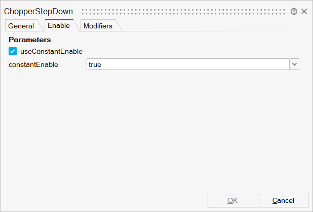

mo_useConstantEnable | useConstantEnable | Disable boolean input and use constantEnable, if true | Number | 0 |
mo_constantEnable | constantEnable | Constant enabling of firing signals | Scalar | true |

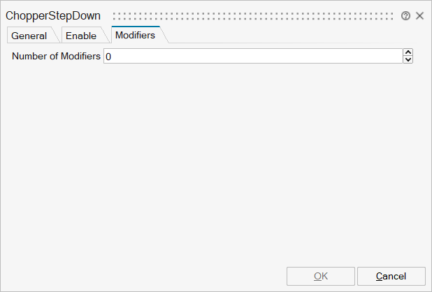

mo__modifiers/varname | Variable name | Cell of strings | 'vDC1' | |
mo__modifiers/value | Value |
