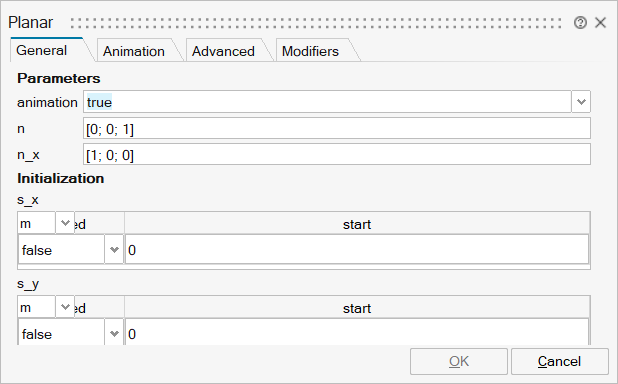

mo_animation | animation | = true, if animation shall be enabled | Scalar | true |
mo_n | n | Axis orthogonal to unconstrained plane, resolved in frame_a (= same as in frame_b) | Vector of size 3 | |
mo_n_x | n_x | Vector in direction of x-axis of plane, resolved in frame_a (n_x shall be orthogonal to n) | Vector of size 3 | |
mo_ndim | ndim | Scalar | ||
mo_e | e | Vector of size 3 | ||
mo_s_x | s_x | s_x | Structure | |
mo_s_x/fixed | fixed | Cell of scalars | true | |
mo_s_x/start | start | Cell of scalars | ||
mo_s_y | s_y | s_y | Structure | |
mo_s_y/fixed | fixed | Cell of scalars | true | |
mo_s_y/start | start | Cell of scalars | ||
mo_phi | phi | phi | Structure | |
mo_phi/fixed | fixed | Cell of scalars | true | |
mo_phi/start | start | Cell of scalars | ||

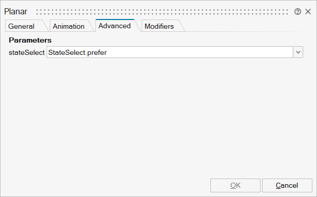

mo_stateSelect | stateSelect | Priority to use joint coordinates (s_x, s_y, phi, v_x, v_y, w) as states | Structure | |
mo_stateSelect/choice1 | StateSelect.never | Number | 0 | |
mo_stateSelect/choice2 | StateSelect.avoid | Number | 0 | |
mo_stateSelect/choice3 | StateSelect.default | Number | 0 | |
mo_stateSelect/choice4 | StateSelect.prefer | Number | 0 | |
mo_stateSelect/choice5 | StateSelect.always | Number | 0 |

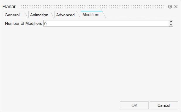

mo__modifiers/value | Value |
