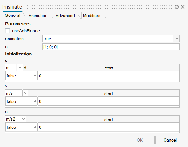

Joint where frame_b is translated along axis n which is fixed in frame_a.The two frames coincide when the relative distance "s = 0".
Optionally, two additional 1-dimensional mechanical flanges(flange "axis" represents the driving flange andflange "support" represents the bearing) can be enabled viaparameter useAxisFlange. The enabled axis flange can bedriven with elements of theModelica.Mechanics.Translationallibrary.

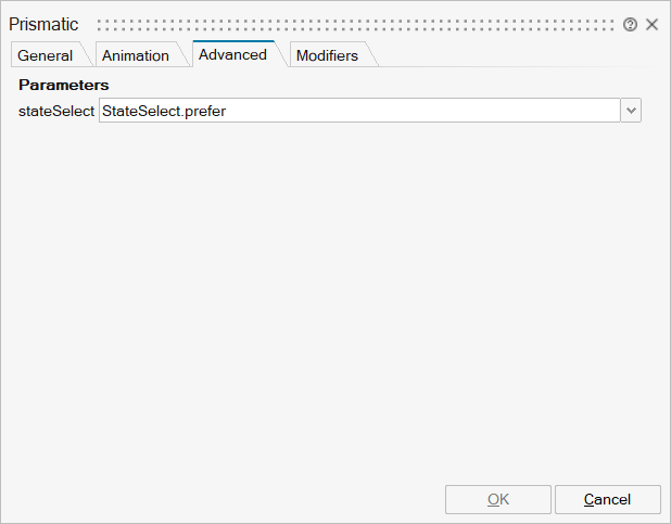

In the "Advanced" menu it can be defined via parameter stateSelectthat the relative distance "s" and its derivative shall be definitelyused as states by setting stateSelect=StateSelect.always.Default is StateSelect.prefer to use the relative distance and itsderivative as preferred states. The states are usually selected automatically.In certain situations, especially when closed kinematic loops are present,it might be slightly more efficient, when using the StateSelect.always setting.

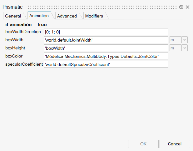

In the following figure the animation of a prismaticjoint is shown. The light blue coordinate system isframe_a and the dark blue coordinate system isframe_b of the joint. The black arrow is parametervector "n" defining the translation axis(here: n = {1,1,0}).
mo_useAxisFlange | useAxisFlange | = true, if axis flange is enabled | Number | 0 |
mo_animation | animation | = true, if animation shall be enabled | Scalar | true |
mo_n | n | Axis of translation resolved in frame_a (= same as in frame_b) | Vector of size 3 | |
mo_e | e | Unit vector in direction of prismatic axis n | Vector of size 3 | |
mo_s | s | s | Structure | |
mo_s/fixed | fixed | Cell of scalars | true | |
mo_s/start | start | Cell of scalars | ||
mo_v | v | v | Structure | |
mo_v/fixed | fixed | Cell of scalars | true | |
mo_v/start | start | Cell of scalars | ||
mo_a | a | a | Structure | |
mo_a/fixed | fixed | Cell of scalars | true | |
mo_a/start | start | Cell of scalars |
mo_boxWidthDirection | boxWidthDirection | Vector in width direction of box, resolved in frame_a | Vector of size 3 | |
mo_boxWidth | boxWidth | Width of prismatic joint box | Scalar | |
mo_boxHeight | boxHeight | Height of prismatic joint box | Scalar | |
mo_boxColor | boxColor | Color of prismatic joint box | Vector of size 3 | |
mo_specularCoefficient | specularCoefficient | Reflection of ambient light (= 0: light is completely absorbed) | Scalar |
mo_stateSelect | stateSelect | Priority to use distance s and v=der(s) as states | Structure | |
mo_stateSelect/choice1 | StateSelect.never | Number | 0 | |
mo_stateSelect/choice2 | StateSelect.avoid | Number | 0 | |
mo_stateSelect/choice3 | StateSelect.default | Number | 0 | |
mo_stateSelect/choice4 | StateSelect.prefer | Number | 0 | |
mo_stateSelect/choice5 | StateSelect.always | Number | 0 |
