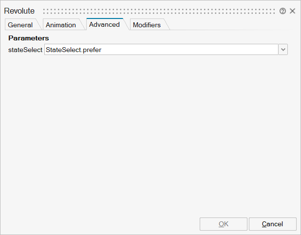

In the "Advanced" menu it can be defined via parameter stateSelectthat the rotation angle "phi" and its derivative shall be definitelyused as states by setting stateSelect=StateSelect.always.Default is StateSelect.prefer to use the joint angle and itsderivative as preferred states. The states are usually selected automatically.In certain situations, especially when closed kinematic loops are present,it might be slightly more efficient, when using the StateSelect.always setting.

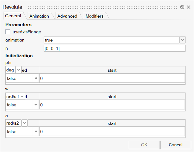

mo_useAxisFlange | useAxisFlange | = true, if axis flange is enabled | Number | 0 |
mo_animation | animation | = true, if animation shall be enabled (show axis as cylinder) | Scalar | true |
mo_n | n | Axis of rotation resolved in frame_a (= same as in frame_b) | Vector of size 3 | |
mo_e | e | Unit vector in direction of rotation axis, resolved in frame_a (= same as in frame_b) | Vector of size 3 | |
mo_phi | phi | phi | Structure | |
mo_phi/fixed | fixed | Cell of scalars | true | |
mo_phi/start | start | Cell of scalars | ||
mo_w | w | w | Structure | |
mo_w/fixed | fixed | Cell of scalars | true | |
mo_w/start | start | Cell of scalars | ||
mo_a | a | a | Structure | |
mo_a/fixed | fixed | Cell of scalars | true | |
mo_a/start | start | Cell of scalars |

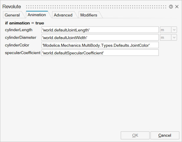

mo_cylinderLength | cylinderLength | Length of cylinder representing the joint axis | Scalar | |
mo_cylinderDiameter | cylinderDiameter | Diameter of cylinder representing the joint axis | Scalar | |
mo_cylinderColor | cylinderColor | Color of cylinder representing the joint axis | Vector of size 3 | |
mo_specularCoefficient | specularCoefficient | Reflection of ambient light (= 0: light is completely absorbed) | Scalar |
mo_stateSelect | stateSelect | Priority to use joint angle phi and w=der(phi) as states | Structure | |
mo_stateSelect/choice1 | StateSelect.never | Number | 0 | |
mo_stateSelect/choice2 | StateSelect.avoid | Number | 0 | |
mo_stateSelect/choice3 | StateSelect.default | Number | 0 | |
mo_stateSelect/choice4 | StateSelect.prefer | Number | 0 | |
mo_stateSelect/choice5 | StateSelect.always | Number | 0 |

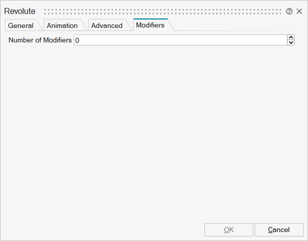

mo__modifiers/varname | Variable name | Cell of strings | 'tau' | |
mo__modifiers/value | Value |
