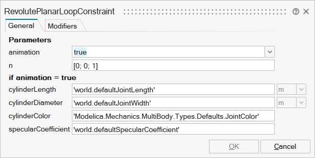

mo_animation | animation | = true, if animation shall be enabled (show axis as cylinder) | Scalar | true |
mo_n | n | Axis of rotation resolved in frame_a (= same as in frame_b) | Vector of size 3 | |
mo_e | e | Unit vector in direction of rotation axis, resolved in frame_a (= same as in frame_b) | Vector of size 3 | |
mo_nnx_a | nnx_a | Arbitrary vector that is not aligned with rotation axis n | Vector of size 3 | |
mo_ey_a | ey_a | Unit vector orthogonal to axis n of revolute joint, resolved in frame_a | Vector of size 3 | |
mo_ex_a | ex_a | Unit vector orthogonal to axis n of revolute joint and to ey_a, resolved in frame_a | Vector of size 3 | |
mo_cylinderLength | cylinderLength | Length of cylinder representing the joint axis | Scalar | |
mo_cylinderDiameter | cylinderDiameter | Diameter of cylinder representing the joint axis | Scalar | |
mo_cylinderColor | cylinderColor | Color of cylinder representing the joint axis | Vector of size 3 | |
mo_specularCoefficient | specularCoefficient | Reflection of ambient light (= 0: light is completely absorbed) | Scalar |
