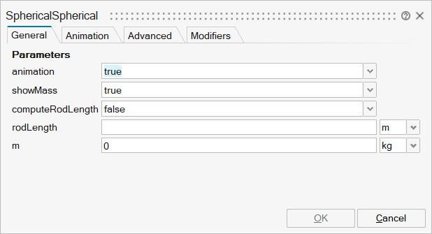

mo_animation | animation | = true, if animation shall be enabled | Scalar | true |
mo_showMass | showMass | = true, if mass shall be shown (provided animation = true and m > 0) | Scalar | true |
mo_computeRodLength | computeRodLength | = true, if rodLength shall be computed during initialization (see info) | Scalar | true |
mo_rodLength | rodLength | Distance between the origins of frame_a and frame_b (if computeRodLength=true, guess value) | Scalar | |
mo_m | m | Mass of rod (= point mass located in middle of rod) | Scalar |

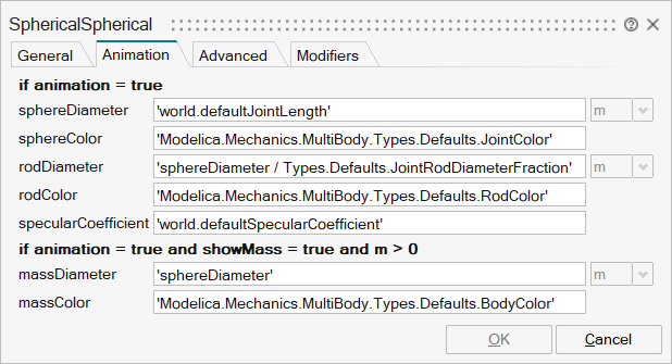

mo_sphereDiameter | sphereDiameter | Diameter of spheres representing the spherical joints | Scalar | |
mo_sphereColor | sphereColor | Color of spheres representing the spherical joints | Vector of size 3 | |
mo_rodDiameter | rodDiameter | Diameter of rod connecting the two spherical joint | Scalar | |
mo_rodColor | rodColor | Color of rod connecting the two spherical joints | Vector of size 3 | |
mo_specularCoefficient | specularCoefficient | Reflection of ambient light (= 0: light is completely absorbed) | Scalar | |
mo_massDiameter | massDiameter | Diameter of sphere representing the mass point | Scalar | |
mo_massColor | massColor | Color of sphere representing the mass point | Vector of size 3 |

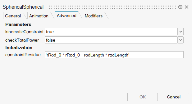

mo_kinematicConstraint | kinematicConstraint | = false, if no constraint shall be defined, due to analytically solving a kinematic loop ("false" should not be used by user, but only by MultiBody.Joints.Assemblies joints) | Scalar | true |
mo_checkTotalPower | checkTotalPower | = true, if total power flowing into this component shall be determined (must be zero) | Scalar | true |
mo_constraintResidue | constraintResidue | Constraint equation of joint in residue form: Either length constraint (= default) or equation to compute rod force (for analytic solution of loops in combination with Internal.RevoluteWithLengthConstraint/PrismaticWithLengthConstraint) | Scalar |

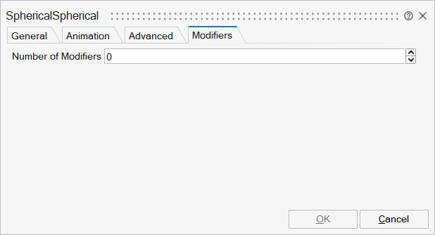

mo__modifiers/varname | Variable name | Cell of strings | 'f_rod' | |
mo__modifiers/value | Value |
