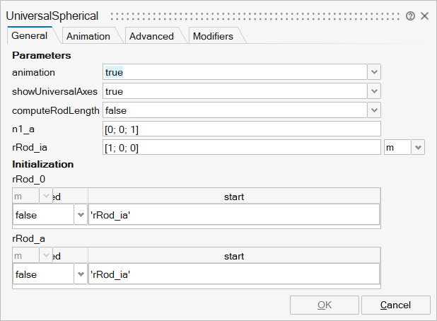

mo_animation | animation | = true, if animation shall be enabled | Scalar | true |
mo_showUniversalAxes | showUniversalAxes | = true, if universal joint shall be visualized with two cylinders, otherwise with a sphere (provided animation=true) | Scalar | true |
mo_computeRodLength | computeRodLength | = true, if distance between frame_a and frame_b shall be computed during initialization (see info) | Scalar | true |
mo_n1_a | n1_a | Axis 1 of universal joint resolved in frame_a (axis 2 is orthogonal to axis 1 and to rod) | Vector of size 3 | |
mo_rRod_ia | rRod_ia | Vector from origin of frame_a to origin of frame_b, resolved in frame_ia (if computeRodLength=true, rRod_ia is only an axis vector along the connecting rod) | Vector of size 3 | |

mo_rRod_0 | rRod_0 | rRod_0 | Structure | |
mo_rRod_0/fixed | fixed | Cell of vectors of size 3 | true | |
mo_rRod_0/start | start | Cell of vectors of size 3 | ||
mo_rRod_a | rRod_a | rRod_a | Structure | |
mo_rRod_a/fixed | fixed | Cell of vectors of size 3 | true | |
mo_rRod_a/start | start | Cell of vectors of size 3 | ||

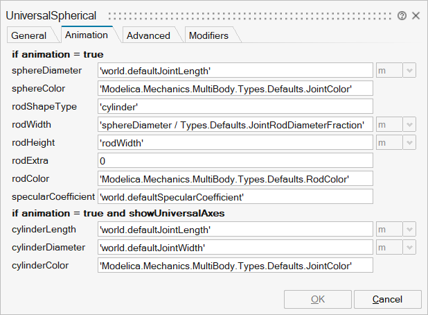

mo_sphereDiameter | sphereDiameter | Diameter of spheres representing the universal and the spherical joint | Scalar | |
mo_sphereColor | sphereColor | Color of spheres representing the universal and the spherical joint | Vector of size 3 | |
mo_rodShapeType | rodShapeType | Shape type of rod connecting the universal and the spherical joint | String | |
mo_rodWidth | rodWidth | Width of rod shape in direction of axis 2 of universal joint. | Scalar | |
mo_rodHeight | rodHeight | Height of rod shape in direction that is orthogonal to rod and to axis 2 | Scalar | |
mo_rodExtra | rodExtra | Additional parameter depending on rodShapeType | Scalar | |
mo_rodColor | rodColor | Color of rod shape connecting the universal and the spherical joints | Vector of size 3 | |
mo_specularCoefficient | specularCoefficient | Reflection of ambient light (= 0: light is completely absorbed) | Scalar | |
mo_cylinderLength | cylinderLength | Length of cylinders representing the two universal joint axes | Scalar | |
mo_cylinderDiameter | cylinderDiameter | Diameter of cylinders representing the two universal joint axes | Scalar | |
mo_cylinderColor | cylinderColor | Color of cylinders representing the two universal joint axes | Vector of size 3 |

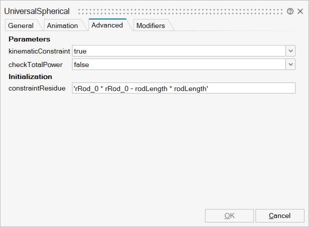

mo_kinematicConstraint | kinematicConstraint | = false, if no constraint shall be defined, due to analytically solving a kinematic loop | Scalar | true |
mo_checkTotalPower | checkTotalPower | = true, if total power flowing into this component shall be determined (must be zero) | Scalar | true |
mo_constraintResidue | constraintResidue | Constraint equation of joint in residue form: Either length constraint (= default) or equation to compute rod force (for analytic solution of loops in combination with Internal.RevoluteWithLengthConstraint/PrismaticWithLengthConstraint) | Scalar |

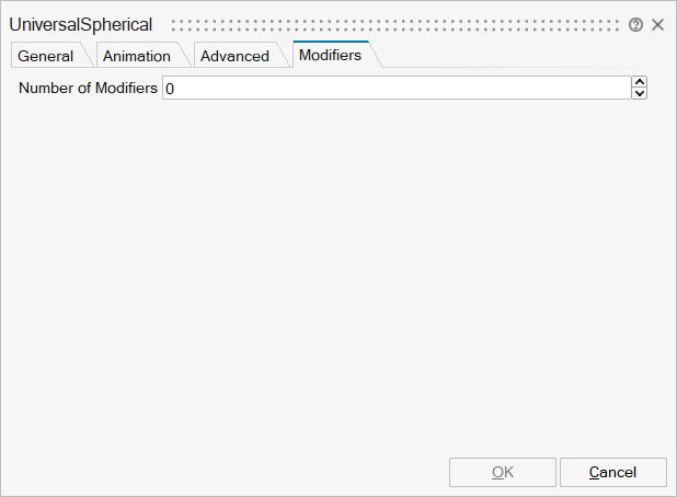

mo__modifiers/varname | Variable name | Cell of strings | 'f_rod' | |
mo__modifiers/value | Value |
