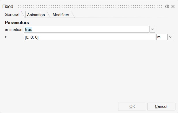

Element consisting of a frame (frame_b) that is fixed in the worldframe at a given position defined by parameter vector r(vector from origin of world frame to frame_b, resolved in theworld frame).

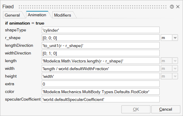

By default, this component is visualized by a cylinder connecting theworld frame and frame_b of this components, as shown in the figure below.Note, that the visualized world frame on the left side andFixed.frame_b on the right side are not part of thecomponent animation and that the animation may be switched off via parameteranimation = false.
mo_animation | animation | = true, if animation shall be enabled | Scalar | true |
mo_r | r | Position vector from world frame to frame_b, resolved in world frame | Vector of size 3 |
mo_shapeType | shapeType | Type of shape | String | |
mo_r_shape | r_shape | Vector from world frame to shape origin, resolved in world frame | Vector of size 3 | |
mo_lengthDirection | lengthDirection | Vector in length direction of shape, resolved in world frame | Vector of size 3 | |
mo_widthDirection | widthDirection | Vector in width direction of shape, resolved in world frame | Vector of size 3 | |
mo_length | length | Length of shape | Scalar | |
mo_width | width | Width of shape | Scalar | |
mo_height | height | Height of shape | Scalar | |
mo_extra | extra | Additional parameter for cone, pipe etc. (see docu of Visualizers.Advanced.Shape) | Scalar | |
mo_color | color | Color of shape | Vector of size 3 | |
mo_specularCoefficient | specularCoefficient | Reflection of ambient light (= 0: light is completely absorbed) | Scalar |

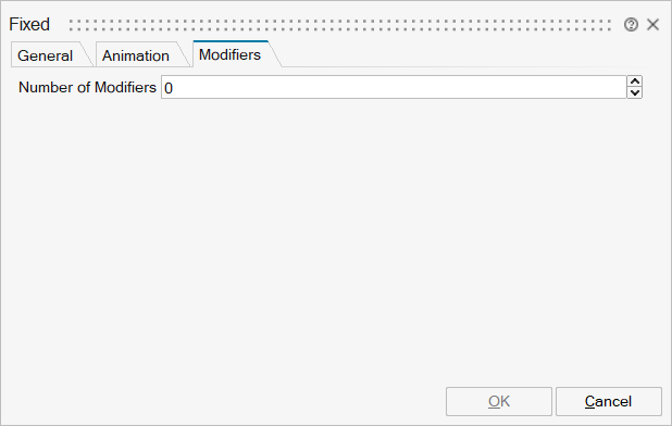

mo__modifiers/value | Value |
