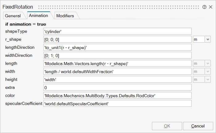

By default, this component is visualized by a cylinder connectingframe_a and frame_b, as shown in the figure below. In this figureframe_b is rotated along the z-axis of frame_a with 60 degree. Note, that thetwo visualized frames are not part of the component animation and thatthe animation may be switched off via parameter animation = false.

mo_shapeType | shapeType | Type of shape | String | |
mo_r_shape | r_shape | Vector from frame_a to shape origin, resolved in frame_a | Vector of size 3 | |
mo_lengthDirection | lengthDirection | Vector in length direction of shape, resolved in frame_a | Vector of size 3 | |
mo_widthDirection | widthDirection | Vector in width direction of shape, resolved in frame_a | Vector of size 3 | |
mo_length | length | Length of shape | Scalar | |
mo_width | width | Width of shape | Scalar | |
mo_height | height | Height of shape | Scalar | |
mo_extra | extra | Additional parameter depending on shapeType (see docu of Visualizers.Advanced.Shape) | Scalar | |
mo_color | color | Color of shape | Vector of size 3 | |
mo_specularCoefficient | specularCoefficient | Reflection of ambient light (= 0: light is completely absorbed) | Scalar |

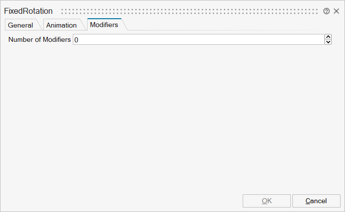

mo__modifiers/value | Value |
