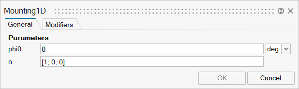

mo_phi0 | phi0 | Fixed offset angle of housing | Scalar | |
mo_n | n | Axis of rotation = axis of support torque (resolved in frame_a) | Vector of size 3 |

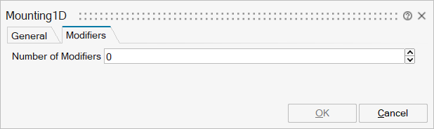

mo__modifiers/value | Value |
