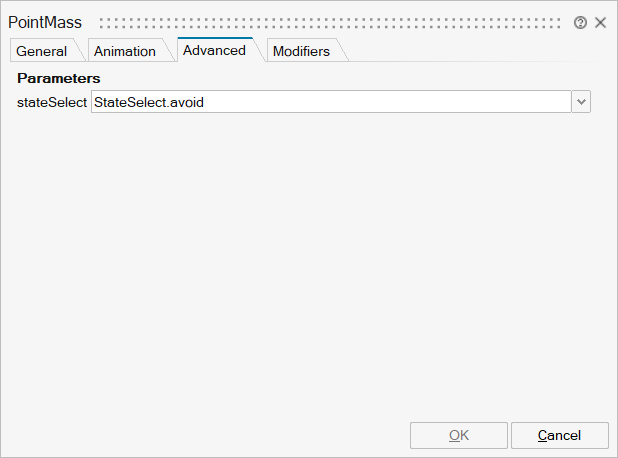

Every PointMass has potential states. If possible a tool will selectthe states of joints and not the states of PointMass because this isusually the most efficient choice. In this case the position andvelocity of frame_a of the body will be computedby the component that is connected to frame_a. However, if a PointMass is movingfreely in space, variables of the PointMass have to be used as states. The potentialstates are: The position vector frame_a.r_0 from the origin of theworld frame to the origin of frame_a of the body, resolved inthe world frame and the absolute velocity v_0 of the origin offrame_a, resolved in the world frame (= der(frame_a.r_0)).
Whether or not variables of the body are used as states is usuallyautomatically selected by the Modelica translator. If parameterenforceStates is set to true in the "Advanced" menu,then PointMass variables frame_a.r_0 and der(frame_a.r_0)are forced to be used as states.

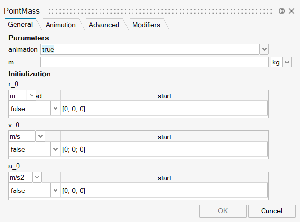

mo_animation | animation | = true, if animation shall be enabled (show sphere) | Scalar | true |
mo_m | m | Mass of mass point | Scalar | |
mo_r_0 | r_0 | r_0 | Structure | |
mo_r_0/fixed | fixed | Cell of vectors of size 3 | true | |
mo_r_0/start | start | Cell of vectors of size 3 | ||
mo_v_0 | v_0 | v_0 | Structure | |
mo_v_0/fixed | fixed | Cell of vectors of size 3 | true | |
mo_v_0/start | start | Cell of vectors of size 3 | ||
mo_a_0 | a_0 | a_0 | Structure | |
mo_a_0/fixed | fixed | Cell of vectors of size 3 | true | |
mo_a_0/start | start | Cell of vectors of size 3 |

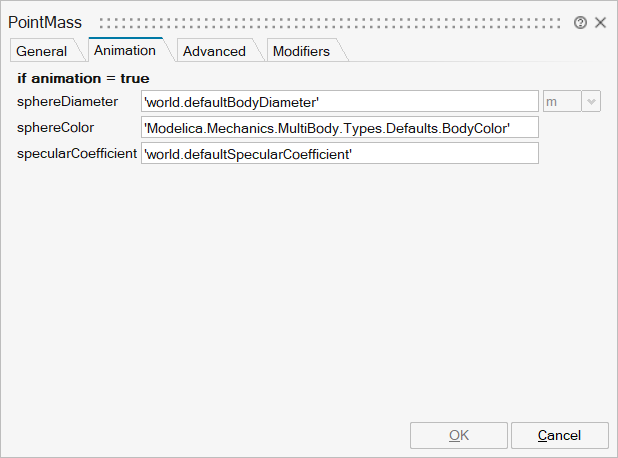

mo_sphereDiameter | sphereDiameter | Diameter of sphere | Scalar | |
mo_sphereColor | sphereColor | Color of sphere | Vector of size 3 | |
mo_specularCoefficient | specularCoefficient | Reflection of ambient light (= 0: light is completely absorbed) | Scalar |
mo_stateSelect | stateSelect | Priority to use frame_a.r_0, v_0 (= der(frame_a.r_0)) as states | Structure | |
mo_stateSelect/choice1 | StateSelect.never | Number | 0 | |
mo_stateSelect/choice2 | StateSelect.avoid | Number | 0 | |
mo_stateSelect/choice3 | StateSelect.default | Number | 0 | |
mo_stateSelect/choice4 | StateSelect.prefer | Number | 0 | |
mo_stateSelect/choice5 | StateSelect.always | Number | 0 |

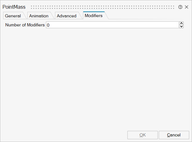

mo__modifiers/value | Value |
