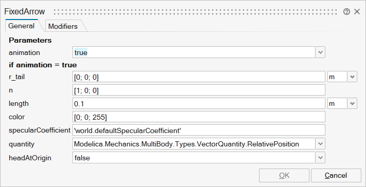

mo_animation | animation | = true, if animation shall be enabled | Scalar | true |
mo_r_tail | r_tail | Vector from frame_a to arrow tail, resolved in frame_a | Vector of size 3 | |
mo_n | n | Vector in arrow direction, resolved in frame_a | Vector of size 3 | |
mo_length | length | Length of complete arrow | Scalar | |
mo_color | color | Color of arrow | Vector of size 3 | |
mo_specularCoefficient | specularCoefficient | Reflection of ambient light (= 0: light is completely absorbed) | Scalar | |
mo_quantity | quantity | Kind of physical quantity represented by the vector | Structure | |
mo_quantity/choice1 | Modelica.Mechanics.MultiBody.Types.VectorQuantity.Force | Number | 0 | |
mo_quantity/choice2 | Modelica.Mechanics.MultiBody.Types.VectorQuantity.Torque | Number | 0 | |
mo_quantity/choice3 | Modelica.Mechanics.MultiBody.Types.VectorQuantity.Velocity | Number | 0 | |
mo_quantity/choice4 | Modelica.Mechanics.MultiBody.Types.VectorQuantity.Acceleration | Number | 0 | |
mo_quantity/choice5 | Modelica.Mechanics.MultiBody.Types.VectorQuantity.AngularVelocity | Number | 0 | |
mo_quantity/choice6 | Modelica.Mechanics.MultiBody.Types.VectorQuantity.AngularAcceleration | Number | 0 | |
mo_quantity/choice7 | Modelica.Mechanics.MultiBody.Types.VectorQuantity.RelativePosition | Number | 0 | |
mo_headAtOrigin | headAtOrigin | = true, if the vector is pointing towards the origin of vector frame | Scalar | true |
