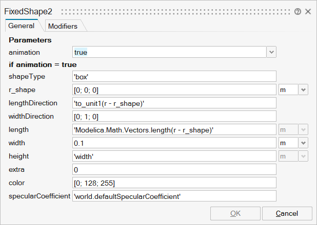

Parameter color is a vector with 3 elements,{r, g, b}, and specifies the color of the shape.{r, g, b} are the "red", "green" and "blue" color parts.Note, r, g, b are given as Integer[3] in the ranges 0 … 255,respectively. The predefined typeMultiBody.Types.Color contains a menudefinition of the colors used in the MultiBody library together with a color editor.

mo_animation | animation | = true, if animation shall be enabled | Scalar | true |
mo_shapeType | shapeType | Type of shape | String | |
mo_r_shape | r_shape | Vector from frame_a to shape origin, resolved in frame_a | Vector of size 3 | |
mo_lengthDirection | lengthDirection | Vector in length direction of shape, resolved in frame_a | Vector of size 3 | |
mo_widthDirection | widthDirection | Vector in width direction of shape, resolved in frame_a | Vector of size 3 | |
mo_length | length | Length of shape | Scalar | |
mo_width | width | Width of shape | Scalar | |
mo_height | height | Height of shape | Scalar | |
mo_extra | extra | Additional data for cylinder, cone, pipe, gearwheel and spring | Scalar | |
mo_color | color | Color of shape | Vector of size 3 | |
mo_specularCoefficient | specularCoefficient | Reflection of ambient light (= 0: light is completely absorbed) | Scalar |
