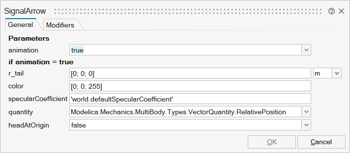

Model SignalArrow defines an arrow that is dynamically visualizedat the location where its frame_a is attached. Thevector from the tail to the head of the arrow,resolved in frame_a, is defined via the signal vector ofthe connector r_head (Real r_head[3]):
The quantity parameter defines what the vector represents, allowingtools to scale e.g. forces and torques differently in a consistent way.For the default value RelativePosition the obvious scaling is1 and the relative position is shown as is.
The tail of the arrow is defined with input r_tailwith respect to frame_a (vector from the origin of frame_a to the arrow tail).
mo_animation | animation | = true, if animation shall be enabled | Scalar | true |
mo_r_tail | r_tail | Vector from frame_a to arrow tail, resolved in frame_a | Vector of size 3 | |
mo_color | color | Color of arrow | Vector of size 3 | |
mo_specularCoefficient | specularCoefficient | Reflection of ambient light (= 0: light is completely absorbed) | Scalar | |
mo_quantity | quantity | Kind of physical quantity represented by the vector | Structure | |
mo_quantity/choice1 | Modelica.Mechanics.MultiBody.Types.VectorQuantity.Force | Number | 0 | |
mo_quantity/choice2 | Modelica.Mechanics.MultiBody.Types.VectorQuantity.Torque | Number | 0 | |
mo_quantity/choice3 | Modelica.Mechanics.MultiBody.Types.VectorQuantity.Velocity | Number | 0 | |
mo_quantity/choice4 | Modelica.Mechanics.MultiBody.Types.VectorQuantity.Acceleration | Number | 0 | |
mo_quantity/choice5 | Modelica.Mechanics.MultiBody.Types.VectorQuantity.AngularVelocity | Number | 0 | |
mo_quantity/choice6 | Modelica.Mechanics.MultiBody.Types.VectorQuantity.AngularAcceleration | Number | 0 | |
mo_quantity/choice7 | Modelica.Mechanics.MultiBody.Types.VectorQuantity.RelativePosition | Number | 0 | |
mo_headAtOrigin | headAtOrigin | = true, if the vector is pointing towards the origin of vector frame | Scalar | true |

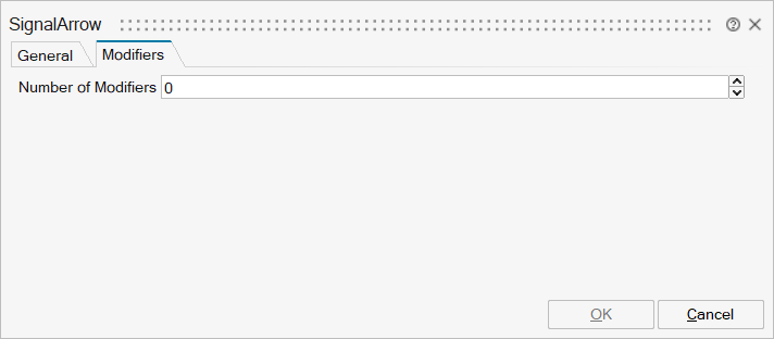

mo__modifiers/value | Value |
