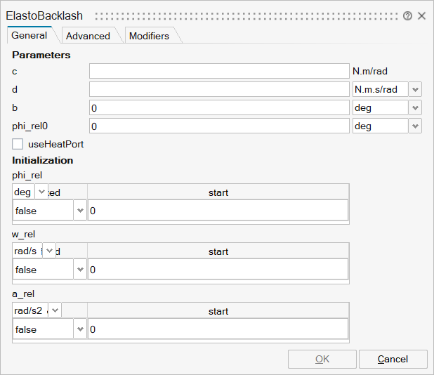

mo_c
c
Spring constant (c > 0 required)
Scalar
mo_d
d
Damping constant
Scalar
mo_b
b
Total backlash
Scalar
mo_phi_rel0
phi_rel0
Unstretched spring angle
Scalar
mo_useHeatPort
useHeatPort
= true, if heatPort is enabled
Number
0
1
mo_bMax
bMax
Backlash in range bMin <= phi_rel - phi_rel0 <= bMax
Scalar
mo_bMin
bMin
Scalar
mo_phi_rel
phi_rel
phi_rel
Structure
mo_phi_rel/fixed
fixed
Cell of scalars
true
false
mo_phi_rel/start
start
Cell of scalars
mo_w_rel
w_rel
w_rel
Structure
mo_w_rel/fixed
fixed
Cell of scalars
true
false
mo_w_rel/start
start
Cell of scalars
mo_a_rel
a_rel
a_rel
Structure
mo_a_rel/fixed
fixed
Cell of scalars
true
false
mo_a_rel/start
start
Cell of scalars

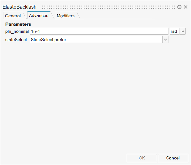

mo_phi_nominal
phi_nominal
Nominal value of phi_rel (used for scaling)
Scalar
mo_stateSelect
stateSelect
Priority to use phi_rel and w_rel as states
Structure
mo_stateSelect/choice1
StateSelect.never
Number
0
1
mo_stateSelect/choice2
StateSelect.avoid
Number
0
1
mo_stateSelect/choice3
StateSelect.default
Number
0
1
mo_stateSelect/choice4
StateSelect.prefer
Number
0
1
mo_stateSelect/choice5
StateSelect.always
Number
0
1

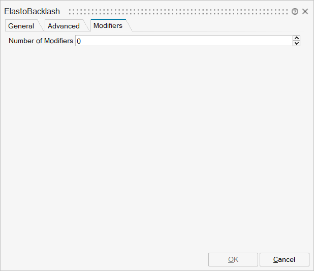

mo__nmodifiers
Number of Modifiers
Specifies the number of modifiers
Number
mo__modifiers
Modifiers
Add new modifier
Structure
mo__modifiers/varname
Variable name
Cell of strings
'tau'
'lossPower'
'tau_c'
'tau_d'
'phi_diff'
mo__modifiers/attribute
Attribute
Cell of strings
'start'
'fixed'
mo__modifiers/value
Value
