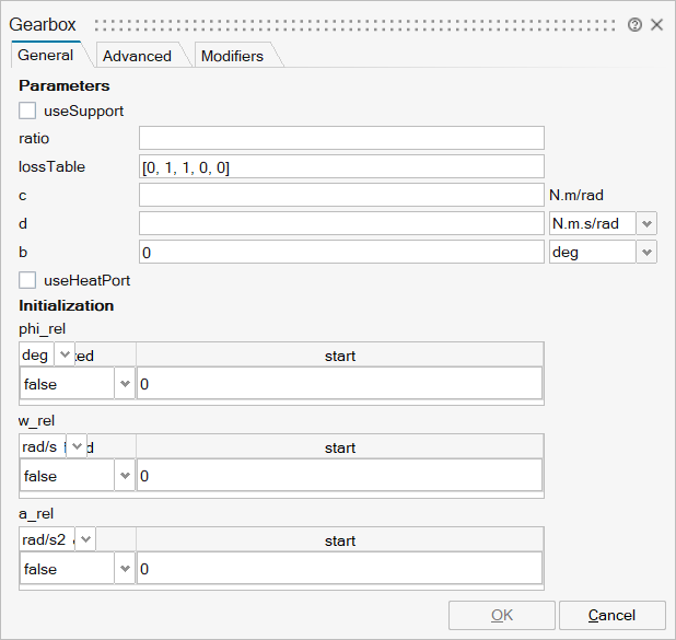

mo_useSupport | useSupport | = true, if support flange enabled, otherwise implicitly grounded | Number | 0 |
mo_ratio | ratio | Transmission ratio (flange_a.phi/flange_b.phi) | Scalar | |
mo_lossTable | lossTable | Array for mesh efficiencies and bearing friction depending on speed (see docu of LossyGear) | Matrix of size Mx5 | |
mo_c | c | Gear elasticity (spring constant) | Scalar | |
mo_d | d | Gear damping (relative damping) | Scalar | |
mo_b | b | Total backlash | Scalar | |
mo_useHeatPort | useHeatPort | = true, if HeatPort is enabled | Number | 0 |
mo_T | T | Fixed device temperature if useHeatPort = false | Scalar | |
mo_phi_rel | phi_rel | phi_rel | Structure | |
mo_phi_rel/fixed | fixed | Cell of scalars | true | |
mo_phi_rel/start | start | Cell of scalars | ||
mo_w_rel | w_rel | w_rel | Structure | |
mo_w_rel/fixed | fixed | Cell of scalars | true | |
mo_w_rel/start | start | Cell of scalars | ||
mo_a_rel | a_rel | a_rel | Structure | |
mo_a_rel/fixed | fixed | Cell of scalars | true | |
mo_a_rel/start | start | Cell of scalars |

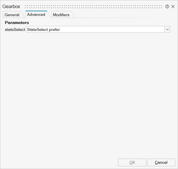

mo_stateSelect | stateSelect | Priority to use phi_rel and w_rel as states | Structure | |
mo_stateSelect/choice1 | StateSelect.never | Number | 0 | |
mo_stateSelect/choice2 | StateSelect.avoid | Number | 0 | |
mo_stateSelect/choice3 | StateSelect.default | Number | 0 | |
mo_stateSelect/choice4 | StateSelect.prefer | Number | 0 | |
mo_stateSelect/choice5 | StateSelect.always | Number | 0 |

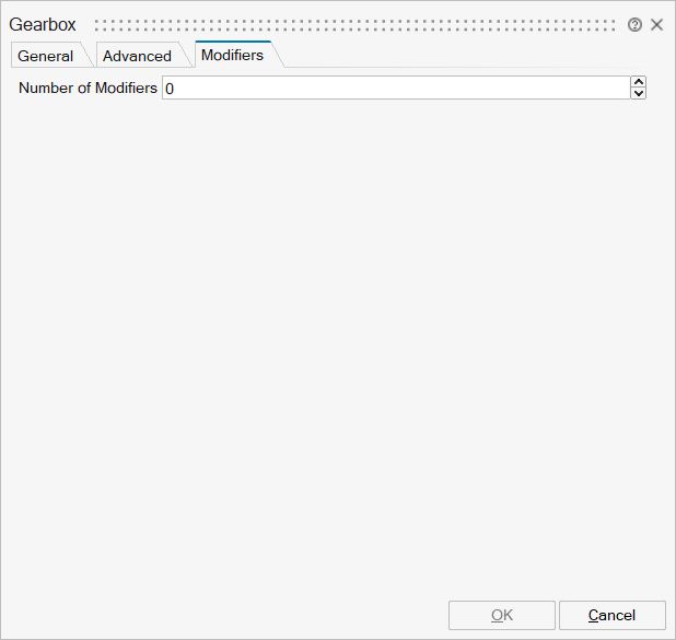

mo__modifiers/value | Value |
