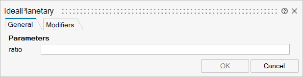

The ideal planetary gearbox is uniquely defined by the ratioof the number of ring teeth zr with respect to the number ofsun teeth zs. For example, if there are 100 ring teeth and50 sun teeth then ratio = zr/zs = 2. The number of planet teethzp has to fulfill the following relationship:
zp := (zr - zs) / 2
Therefore, in the above example zp = 25 is required.
According to the overall convention, the positive direction of allvectors, especially the absolute angular velocities and cut-torquesin the flanges, are along the axis vector displayed in the icon.
mo_ratio | ratio | Number of ring_teeth/sun_teeth (e.g., ratio=100/50) | Scalar |

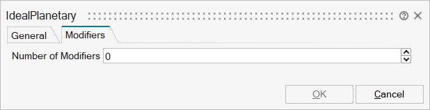

mo__modifiers/value | Value |
