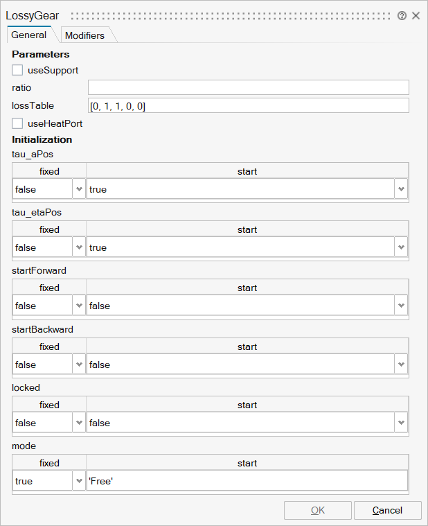

mo_useSupport | useSupport | = true, if support flange enabled, otherwise implicitly grounded | Number | 0 |
mo_ratio | ratio | Transmission ratio (flange_a.phi/flange_b.phi) | Scalar | |
mo_lossTable | lossTable | Array for mesh efficiencies and bearing friction depending on speed | Matrix of size Mx5 | |
mo_useHeatPort | useHeatPort | = true, if heatPort is enabled | Number | 0 |
mo_eta_mf1_0 | eta_mf1_0 | Scalar | ||
mo_eta_mf2_0 | eta_mf2_0 | Scalar | ||
mo_tau_bf1_0 | tau_bf1_0 | Scalar | ||
mo_tau_bf2_0 | tau_bf2_0 | Scalar | ||
mo_tau_bf_a_0 | tau_bf_a_0 | Scalar | ||
mo_tau_aPos | tau_aPos | tau_aPos | Structure | |
mo_tau_aPos/fixed | fixed | Cell of scalars | true | |
mo_tau_aPos/start | start | Cell of scalars | true | |
mo_tau_etaPos | tau_etaPos | tau_etaPos | Structure | |
mo_tau_etaPos/fixed | fixed | Cell of scalars | true | |
mo_tau_etaPos/start | start | Cell of scalars | true | |
mo_startForward | startForward | startForward | Structure | |
mo_startForward/fixed | fixed | Cell of scalars | true | |
mo_startForward/start | start | Cell of scalars | true | |
mo_startBackward | startBackward | startBackward | Structure | |
mo_startBackward/fixed | fixed | Cell of scalars | true | |
mo_startBackward/start | start | Cell of scalars | true | |
mo_locked | locked | locked | Structure | |
mo_locked/fixed | fixed | Cell of scalars | true | |
mo_locked/start | start | Cell of scalars | true | |
mo_mode | mode | mode | Structure | |
mo_mode/fixed | fixed | Cell of scalars | true | |
mo_mode/start | start | Cell of scalars |

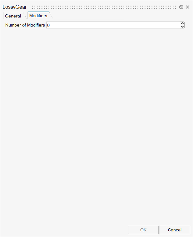

mo__modifiers/varname | Variable name | Cell of strings | 'phi_support' | |
mo__modifiers/value | Value |
