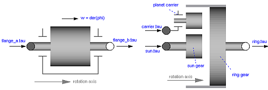

The equations of a mechanical component are vector equations, i.e.,they need to be expressed in a common coordinate system.Therefore, for a component a local axis of rotation has to bedefined. All vector quantities, such as cut-torques or angularvelocities have to be expressed according to this definition.Examples for such a definition are given in the following figurefor an inertia component and a planetary gearbox:
As can be seen, all vectors are directed into the directionof the rotation axis. The angles in the flanges are definedcorrespondingly. For example, the angle sun.phi in theflange of the sun wheel of the planetary gearbox is positive,if rotated in mathematical positive direction (= counter clockwise) along the axis of rotation.

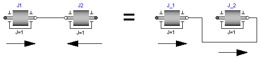

On first view, one may assume that the selected localcoordinate system has an influence on the usage of thecomponent. But this is not the case, as shown in the next figure:
In the figure the local axes of rotation of the componentsare shown. The connection of two inertias in the left and in theright part of the figure are completely equivalent, i.e., the rightpart is just a different drawing of the left part. This is due to thefact, that by a connection, the two local coordinate systems aremade identical and the (automatically) generated connection equations(= angles are identical, cut-torques sum-up to zero) are alsoexpressed in this common coordinate system. Therefore, even if inthe left figure it seems to be that the angular velocity vector ofJ2 goes from right to left, in reality it goes fromleft to right as shown in the right part of the figure, where thelocal coordinate systems are drawn such that they are aligned.Note, that the simple rule stated in sectionSign conventionsalso determines thatthe angular velocity of J2 in the left part of thefigure is directed from left to right.
To summarize, the local coordinate system selected for a componentis just necessary, in order that the equations of this componentare expressed correctly. The selection of the coordinate systemis arbitrary and has no influence on the usage of the component.Especially, the actual direction of, e.g., a cut-torque is mosteasily determined by the rule of sectionSign conventions.A more strict determinationby aligning coordinate systems and then using the vector directionof the local coordinate systems, often requires a re-drawing of thediagram and is therefore less convenient to use.
