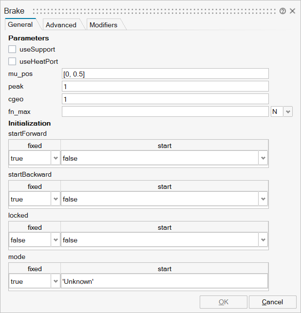

mo_useSupport | useSupport | = true, if support flange enabled, otherwise implicitly grounded | Number | 0 |
mo_useHeatPort | useHeatPort | = true, if heatPort is enabled | Number | 0 |
mo_mu_pos | mu_pos | Positive sliding friction coefficient [-] as function of v_rel [m/s] (v_rel>=0) | Matrix of size Mx2 | |
mo_peak | peak | Peak for maximum value of mu at w==0 (mu0_max = peak*mu_pos[1,2]) | Scalar | |
mo_cgeo | cgeo | Geometry constant containing friction distribution assumption | Scalar | |
mo_fn_max | fn_max | Maximum normal force | Scalar | |
mo_startForward | startForward | startForward | Structure | |
mo_startForward/fixed | fixed | Cell of scalars | true | |
mo_startForward/start | start | Cell of scalars | true | |
mo_startBackward | startBackward | startBackward | Structure | |
mo_startBackward/fixed | fixed | Cell of scalars | true | |
mo_startBackward/start | start | Cell of scalars | true | |
mo_locked | locked | locked | Structure | |
mo_locked/fixed | fixed | Cell of scalars | true | |
mo_locked/start | start | Cell of scalars | true | |
mo_mode | mode | mode | Structure | |
mo_mode/fixed | fixed | Cell of scalars | true | |
mo_mode/start | start | Cell of scalars |

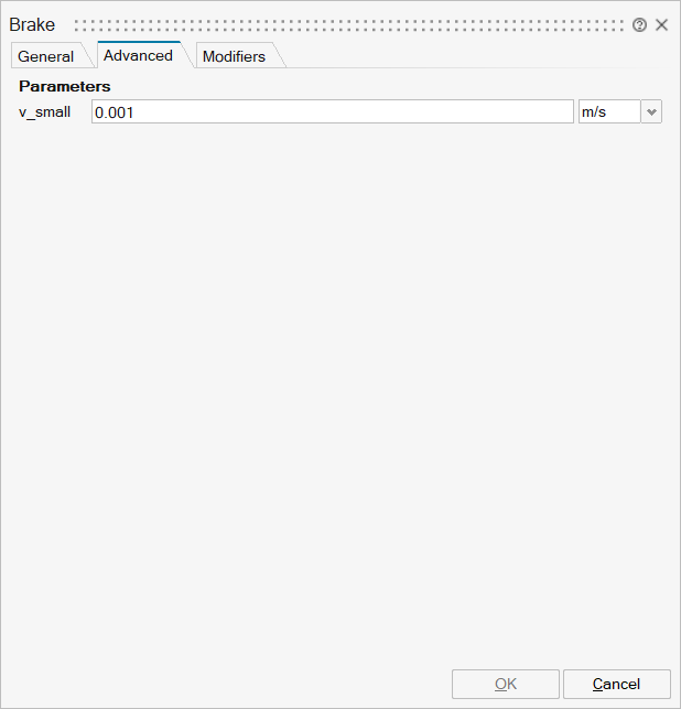

mo_v_small | v_small | Relative velocity near to zero (see model info text) | Scalar |

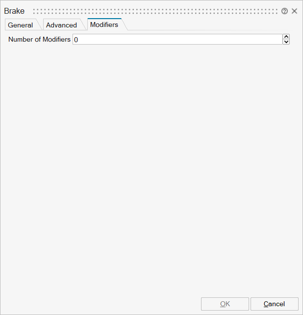

mo__modifiers/varname | Variable name | Cell of strings | 's_a' | |
mo__modifiers/value | Value |
