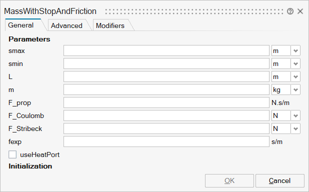

mo_smax | smax | Right stop for (right end of) sliding mass | Scalar | |
mo_smin | smin | Left stop for (left end of) sliding mass | Scalar | |
mo_L | L | Length of component, from left flange to right flange (= flange_b.s - flange_a.s) | Scalar | |
mo_m | m | Mass | Scalar | |
mo_F_prop | F_prop | Velocity dependent friction | Scalar | |
mo_F_Coulomb | F_Coulomb | Constant friction: Coulomb force | Scalar | |
mo_F_Stribeck | F_Stribeck | Stribeck effect | Scalar | |
mo_fexp | fexp | Exponential decay | Scalar | |
mo_useHeatPort | useHeatPort | = true, if heatPort is enabled | Number | 0 |

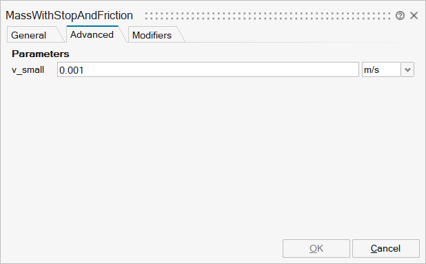

mo_v_small | v_small | Relative velocity near to zero (see model info text) | Scalar |

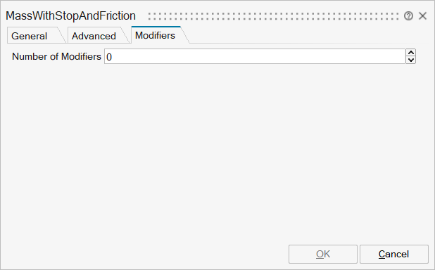

mo__modifiers/varname | Variable name | Cell of strings | 'v_relfric' | |
mo__modifiers/value | Value |
