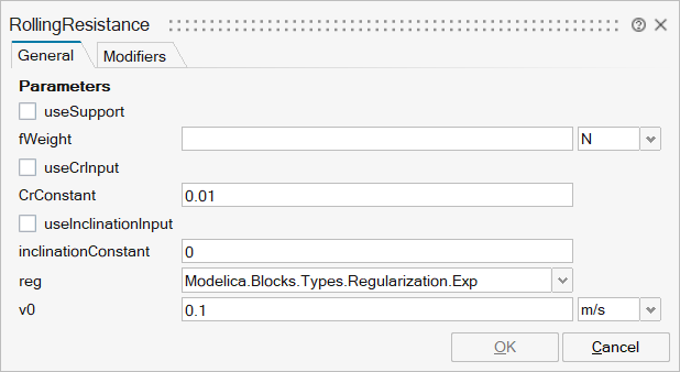

mo_useSupport | useSupport | = true, if support flange enabled, otherwise implicitly grounded | Number | 0 |
mo_fWeight | fWeight | Wheel load due to gravity | Scalar | |
mo_useCrInput | useCrInput | Enable signal input for Cr | Number | 0 |
mo_CrConstant | CrConstant | Constant rolling resistance coefficient | Scalar | |
mo_useInclinationInput | useInclinationInput | Enable signal input for inclination | Number | 0 |
mo_inclinationConstant | inclinationConstant | Constant inclination = tan(angle) | Scalar | |
mo_reg | reg | Type of regularization | Structure | |
mo_reg/choice1 | Modelica.Blocks.Types.Regularization.Exp | Number | 0 | |
mo_reg/choice2 | Modelica.Blocks.Types.Regularization.Sine | Number | 0 | |
mo_reg/choice3 | Modelica.Blocks.Types.Regularization.Linear | Number | 0 | |
mo_reg/choice4 | Modelica.Blocks.Types.Regularization.Cosine | Number | 0 | |
mo_v0 | v0 | Regularization below v0 | Scalar |
