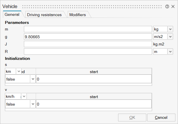

Mass and inertia
Both the translational vehicle mass and the rotational inertias (e.g. the wheels)are accelerated when the vehicle is accelerated.This nature is usually put into account for fundamental vehicle analysesdone either in the rotational or translational domain, e.g. when analysingvehicle's driveline.Then, the vehicle mass m can be expressed as an additionalequivalent inertia J_eq = m * R2 orvice versa rotational inertia J as an additionalequivalent mass m_eq = J/R2,where R is the wheel radius.Since this model introduces rolling resistance and inclination resistance as wellwhere just the vehicle mass plays a role,the approach of equivalent mass/inertia would lead to incorrect simulation resultsand shall therefore not be applied here.

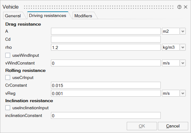

Drag resistance
fDrag = Cd*rho*A*(v - vWind)^2/2
Wind velocity is measured in the same direction as velocity of flangeT.Wind velocity is either constant or prescribed by the input vWind.
Rolling resistance
fRoll = Cr*m*g*cos(alpha)
Rolling resistance coefficient Cr is either constantor prescribed by the input cr.Rolling resistance has a crossover from positive to negative velocity within [-vReg, vReg].
The inclination angle α is either constant or prescribed bythe input inclination = tan(α).This corresponds to the road rise over running distance of 100 m which,in general, is written as a percentage.For example for a road rising by 10 m over 100 m thegrade = 10 % and, thus, the parameterinclinationConstant = 0.1.Positive inclination means driving uphill, negative inclination meansdriving downhill, in case of positive vehicle velocity.
Inclination resistance
fGrav = m*g*sin(alpha)
With the inclination angle α described above.
mo_m | m | Total mass of vehicle | Scalar | |
mo_g | g | Constant gravity acceleration | Scalar | |
mo_J | J | Total rotational inertia of drive train | Scalar | |
mo_R | R | Wheel radius | Scalar | |
mo_s | s | s | Structure | |
mo_s/fixed | fixed | Cell of scalars | true | |
mo_s/start | start | Cell of scalars | ||
mo_v | v | v | Structure | |
mo_v/fixed | fixed | Cell of scalars | true | |
mo_v/start | start | Cell of scalars |
mo_A | A | Cross section of vehicle | Scalar | |
mo_Cd | Cd | Drag resistance coefficient | Scalar | |
mo_rho | rho | Density of air | Scalar | |
mo_useWindInput | useWindInput | Enable signal input for wind velocity | Number | 0 |
mo_vWindConstant | vWindConstant | Constant wind velocity | Scalar | |
mo_useCrInput | useCrInput | Enable signal input for Cr | Number | 0 |
mo_CrConstant | CrConstant | Constant rolling resistance coefficient | Scalar | |
mo_vReg | vReg | Velocity for regularization around 0 | Scalar | |
mo_useInclinationInput | useInclinationInput | Enable signal input for inclination | Number | 0 |
mo_inclinationConstant | inclinationConstant | Constant inclination = tan(angle) | Scalar |

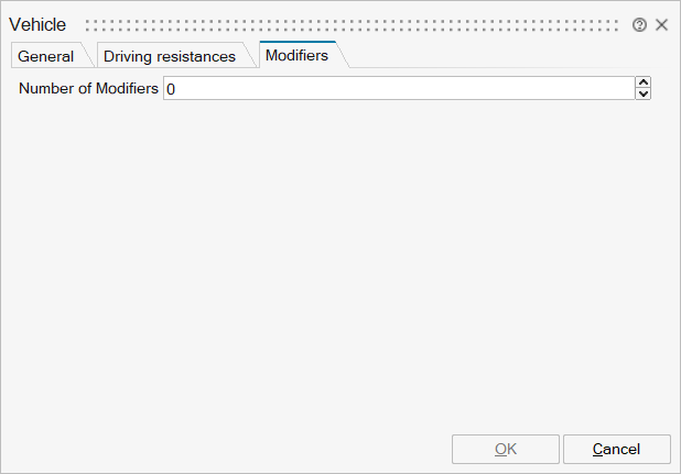

mo__modifiers/varname | Variable name | Cell of strings | 'a' | |
mo__modifiers/value | Value |
