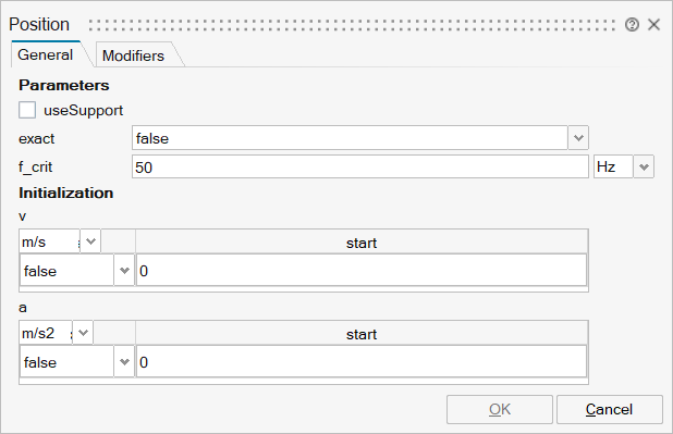

mo_useSupport | useSupport | = true, if support flange enabled, otherwise implicitly grounded | Number | 0 |
mo_exact | exact | Is true/false for exact treatment/filtering of the input signal, respectively | Scalar | true |
mo_f_crit | f_crit | If exact=false, critical frequency of filter to filter input signal | Scalar | |
mo_w_crit | w_crit | Critical frequency | Scalar | |
mo_v | v | v | Structure | |
mo_v/fixed | fixed | Cell of scalars | true | |
mo_v/start | start | Cell of scalars | ||
mo_a | a | a | Structure | |
mo_a/fixed | fixed | Cell of scalars | true | |
mo_a/start | start | Cell of scalars |

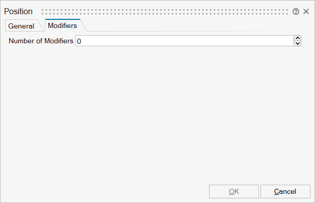

mo__modifiers/varname | Variable name | Cell of strings | 's' | |
mo__modifiers/value | Value |
