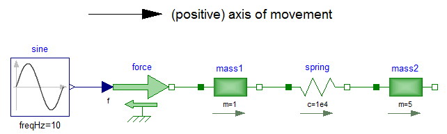

The variables of a component of this library can be accessed in theusual way. However, since most of these variables are basically elementsof vectors, i.e., have a direction, the question arises how thesigns of variables shall be interpreted. The basic idea is explainedat hand of the following figure:
drive2

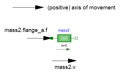

First, one has to definea positive direction of this line, called axis of movement.In the top of the figure this is characterized by an arrowand a corresponding text. The simple rule is now:If a variable of a component is positive and can be interpreted asthe element of a vector (e.g., force or velocity vector), thecorresponding vector is directed into the positive directionof the axis of movement. In the following figure, the right-mostmass of the figure above is displayed with the positivevector direction displayed according to this rule:
drive3
The cut-force mass2.flange_a.fof the right mass is directed into thedirection of movement if the values are positive. Similarly,the velocity mass2.v of the right massis also directed into thedirection of movement if the values are positive
