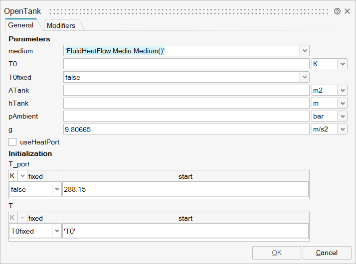

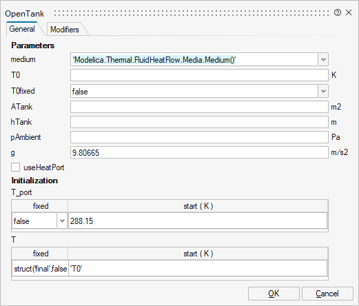

mo_medium | medium | Medium | FromModelica('Modelica.Thermal.FluidHeatFlow.Media.Medium') | |
mo_T0 | T0 | Initial temperature of medium | Scalar | |
mo_T0fixed | T0fixed | Initial temperature guess value or fixed | Scalar | true |
mo_ATank | ATank | Cross section of tank | Scalar | |
mo_hTank | hTank | Height of tank | Scalar | |
mo_pAmbient | pAmbient | Ambient pressure | Scalar | |
mo_g | g | Gravitation | Scalar | |
mo_useHeatPort | useHeatPort | = true, if HeatPort is enabled | Number | 0 |
mo_T_port | T_port | T_port | Structure | |
mo_T_port/fixed | fixed | Cell of scalars | true | |
mo_T_port/start | start | Cell of scalars | ||
mo_T | T | T | Structure | |
mo_T/fixed | fixed | Cell of scalars | true | |
mo_T/start | start | Cell of scalars |

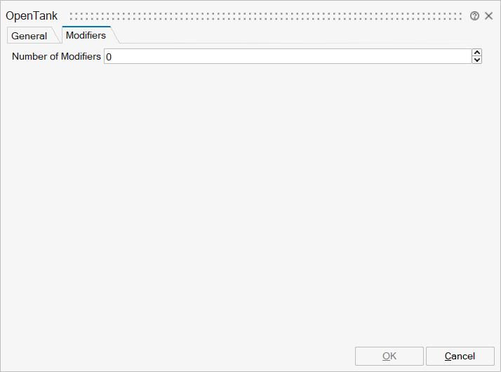

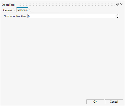

mo__modifiers/varname | Variable name | Cell of strings | 'h' | |
mo__modifiers/value | Value |
