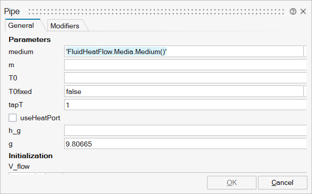

Pipe
Pipe with optional heat exchange
Modelica/Thermal/FluidHeatFlow/Components
Pipe with optional heat exchange.
Thermodynamic equations are defined by BaseClasses.TwoPort.Q_flow is defined by heatPort.Q_flow (useHeatPort=true) or zero (useHeatPort=false).
Note: Setting parameter m (mass of medium within pipe) to zeroleads to neglect of temperature transient cv*m*der(T).
Note: Injecting heat into a pipe with zero mass flow causestemperature rise defined by storing heat in medium's mass.
mo_medium | medium | Medium in the component | FromModelica('Modelica.Thermal.FluidHeatFlow.Media.Medium') | |
mo_m | m | Mass of medium | Scalar | |
mo_T0 | T0 | Initial temperature of medium | Scalar | |
mo_T0fixed | T0fixed | Initial temperature guess value or fixed | Scalar | true |
mo_tapT | tapT | Defines temperature of heatPort between inlet and outlet temperature | Scalar | |
mo_dpNomMin | dpNomMin | Scalar | ||
mo_k | k | Scalar | ||
mo_useHeatPort | useHeatPort | = true, if HeatPort is enabled | Number | 0 |
mo_h_g | h_g | Geodetic height (height difference from flowPort_a to flowPort_b) | Scalar | |
mo_g | g | Gravitation | Scalar | |
mo_V_flow | V_flow | V_flow | Structure | |
mo_V_flow/fixed | fixed | Cell of scalars | true | |
mo_V_flow/start | start | Cell of scalars | ||
mo_T | T | T | Structure | |
mo_T/fixed | fixed | Cell of scalars | true | |
mo_T/start | start | Cell of scalars | ||
mo_T_a | T_a | T_a | Structure | |
mo_T_a/fixed | fixed | Cell of scalars | true | |
mo_T_a/start | start | Cell of scalars | ||
mo_T_b | T_b | T_b | Structure | |
mo_T_b/fixed | fixed | Cell of scalars | true | |
mo_T_b/start | start | Cell of scalars | ||
mo_T_q | T_q | T_q | Structure | |
mo_T_q/fixed | fixed | Cell of scalars | true | |
mo_T_q/start | start | Cell of scalars | ||
mo_h | h | h | Structure | |
mo_h/fixed | fixed | Cell of scalars | true | |
mo_h/start | start | Cell of scalars | ||
mo_V_flowLaminar | V_flowLaminar | Laminar volume flow | Scalar | |
mo_dpLaminar | dpLaminar | Laminar pressure drop | Scalar | |
mo_V_flowNominal | V_flowNominal | Nominal volume flow | Scalar | |
mo_dpNominal | dpNominal | Nominal pressure drop | Scalar | |
mo_frictionLoss | frictionLoss | Part of friction losses fed to medium | Scalar |

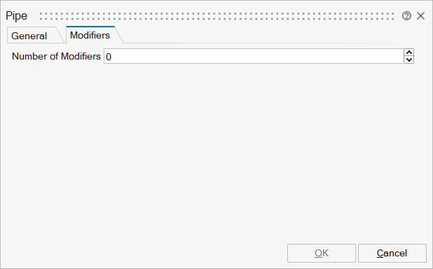

mo__modifiers/varname | Variable name | Cell of strings | 'dp' | |
mo__modifiers/value | Value |
